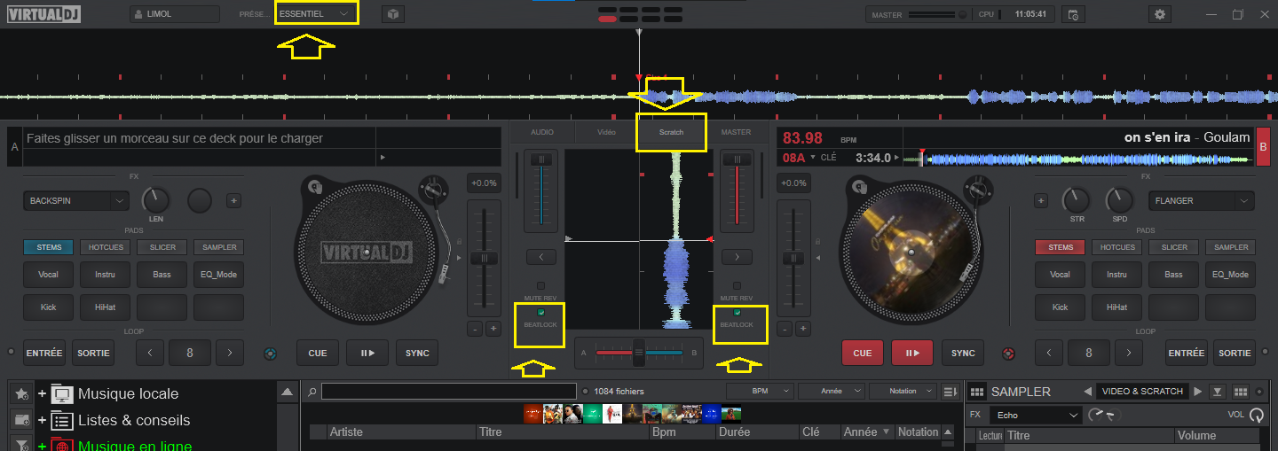

Hello,
you will find the beatlock on the essential skin
then click on the Scratch button and finally activate the Beatlock button
Posted Sun 12 Dec 21 @ 3:14 pm

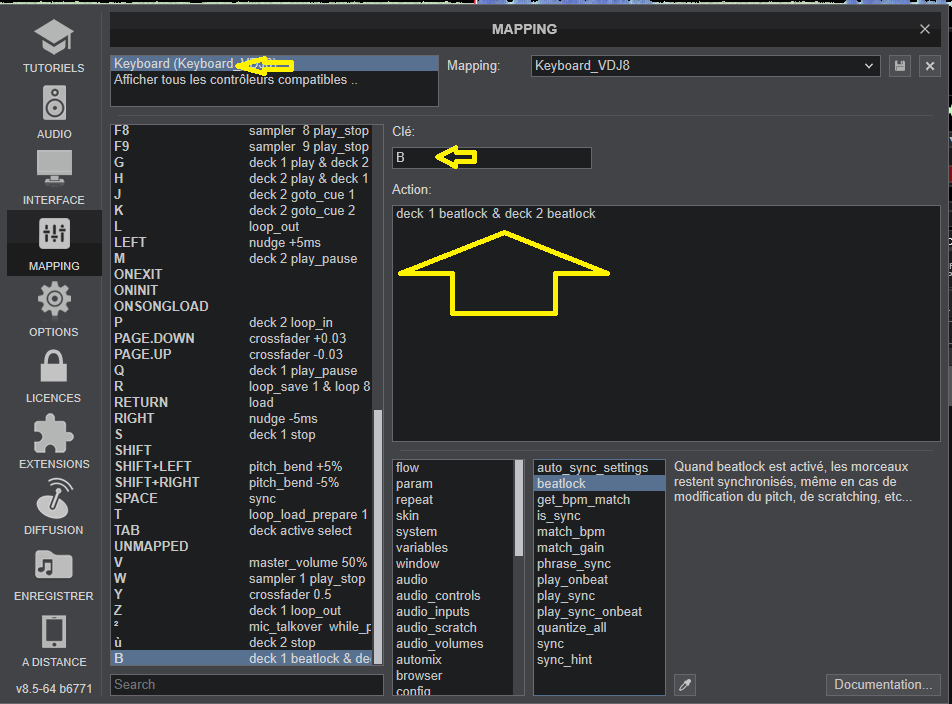

you can also assign the Beatlock action in the Keyboard mapper
in the Key box type the letter B
in the action window type the Script
deck 1 beatlock & deck 2 beatlock
with the B key you can now activate and deactivate the baetlock
