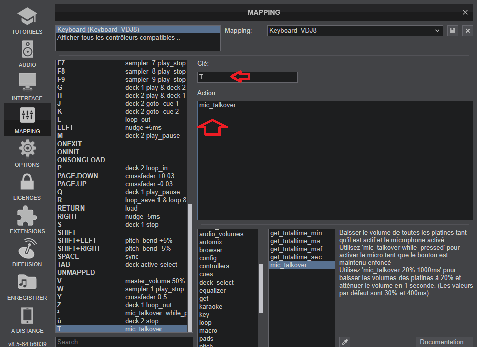

Hello,
simply create a keyboard shortcut by assigning the mic_talkover action to a blank keyboard key or a blank button on your controller in the mapper
Clé: T
Action : mic_talkover
OR
Action: mic_talkover while_pressed
then press the assign button to activate the mic_talkover action
