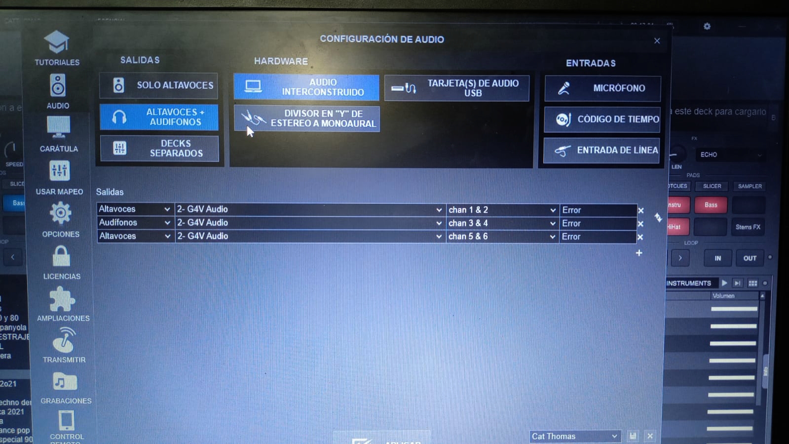

If you could take some screenshots for us, we need to see ..
1. The message / pop-up you get when controller stops working (if you get any)
2. The Audio Setup tab of Settings (to make sure you only use Master & Headphones)

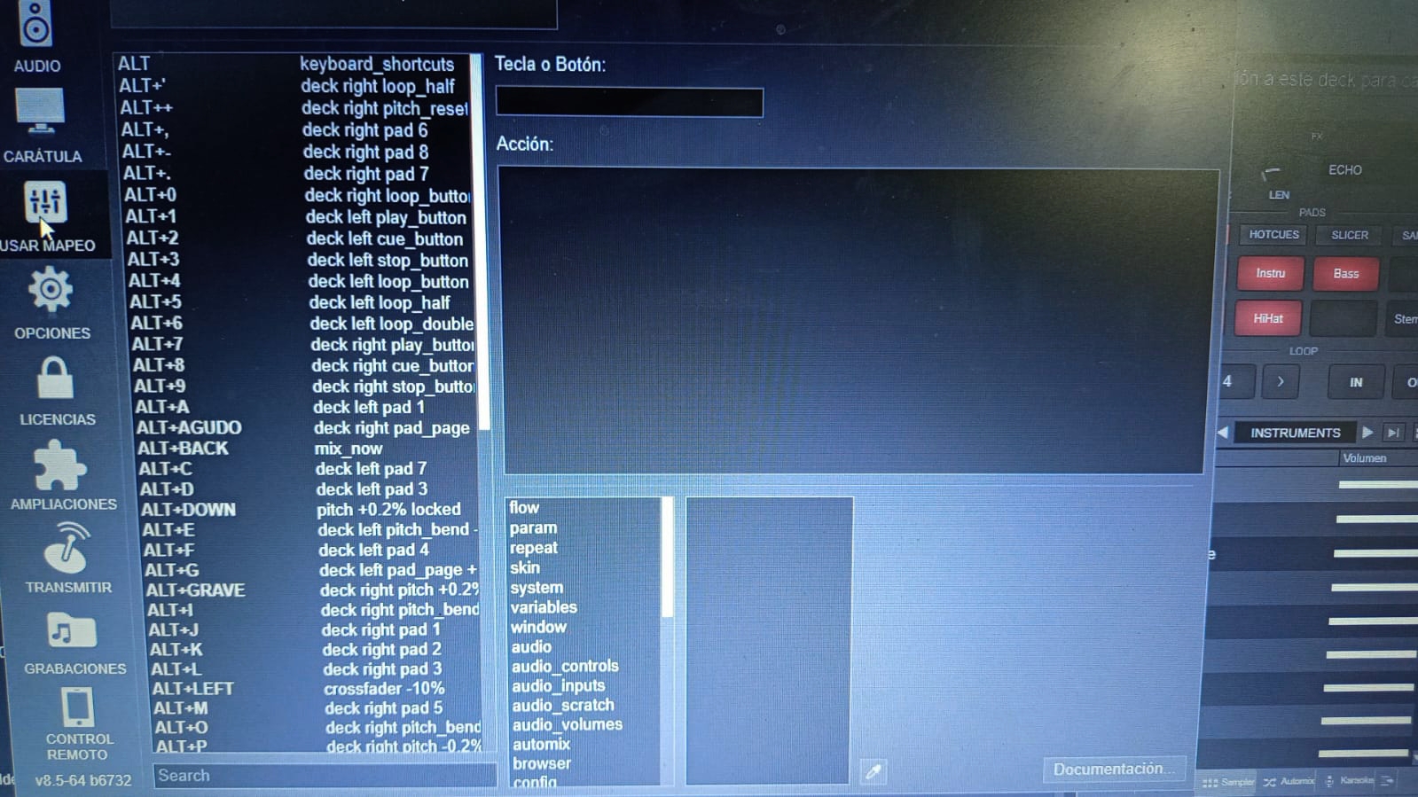

3. The MAPPING tab of Settings (to see if any other device is used/detected there)

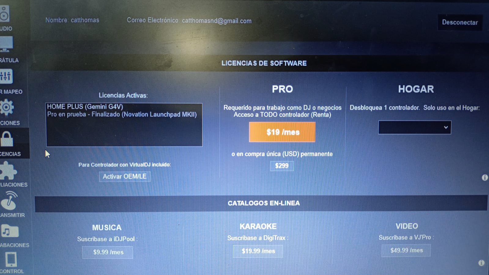

4. The LICENSES tab of Settings (to make sure you are properly logged in and your license is listed)

I share with you the photos to see if there's anything wrong.

Screenshots can be taken from computer without a phone ;) https://www.businessinsider.com/how-to-screenshot-on-windows
1st photo is not clear because i cant see what devices are connected - missing the top part - so not very useful.
2nd photo looks ok, your licenses is there, you are properly logged in.
3rd photo appears as if the controller is not connected. So it doesnt show the "GEMINI G4V" button under the "HARDWARE' tab and at the right side of your setup it shows "Error" for the G4V Audio device.
If this photo was taken with the controller connected, then your issue is probably on the USB connection (bad USB port of computer, bad USB cable, bad USB socket of controller)
BTW, you dont need the 2nd Master Output. I dont think the G4V has any further USB Audio channels than 1,2 (for Master) and 3,4 (for Headphones). Channels 5,6 may be offered in the drop down but that's probably faulty reported from driver, so remove it.

I wasn't home, so it was my dad who took the photos and might have not connected the controller (sorry about it, I'll resend the photos correctly).
And about the channels, there are 6 because he uses headphones, PA speakers and monitor speakers. Would that be right?
Posted Wed 17 Nov 21 @ 12:22 pm
You only need master on channels 1,2 and headphones on 3,4
Connect your pa speakers to the master (xlr if possible) and your monitors to either the second master output (phono) or the booth output (phono). The booth may be preferable as you will then have separate master and booth volume controls (in the middle of the G4V).
