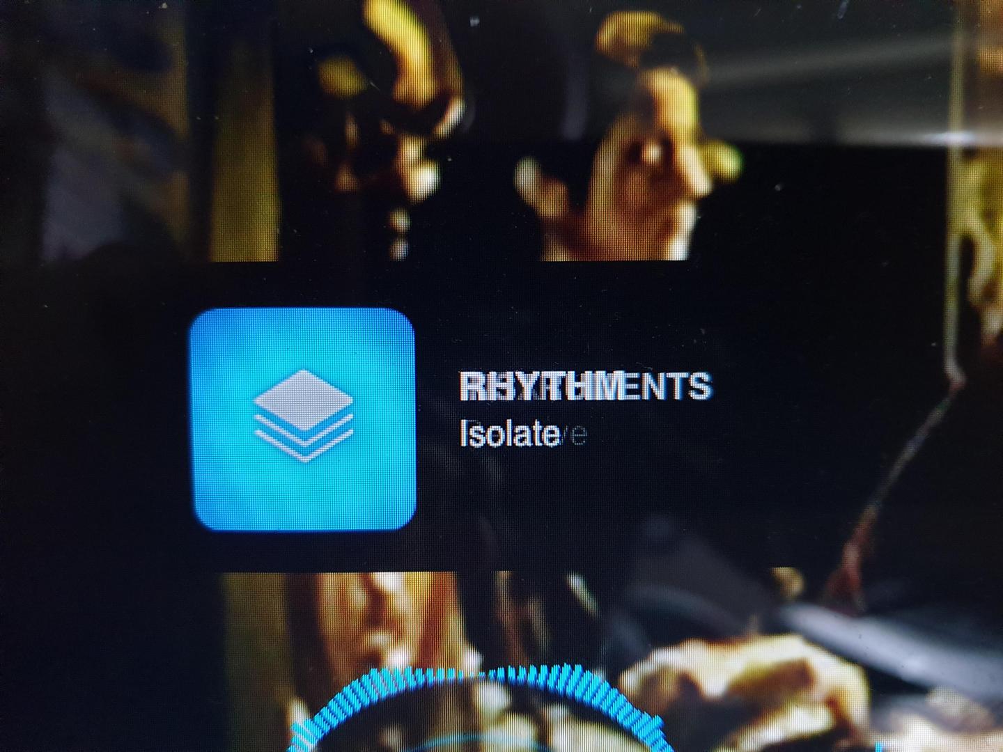

Thanks PhantomDeeJay for your time. In addition to the solutions I tried, I just tried the one you suggested, unfortunately the result does not change the names of the stems are always overlapped and this time no group (isolate, remove) appears with the correct names.
here are the complete commands:
<define class="stemspanel">

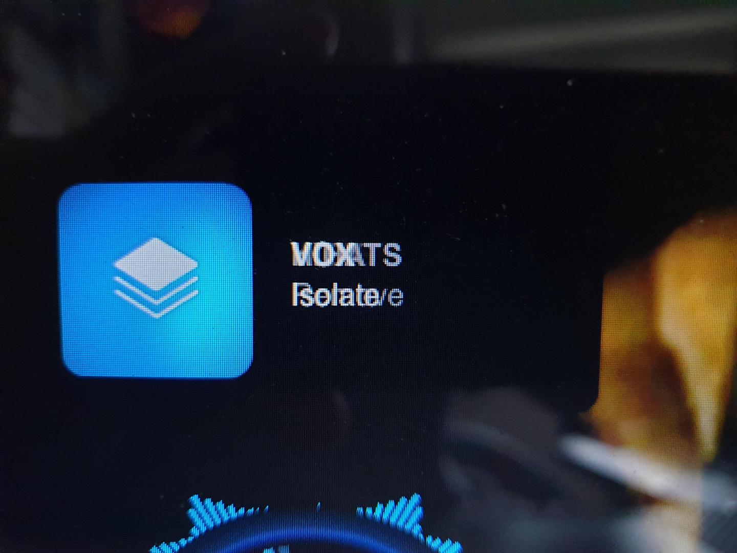

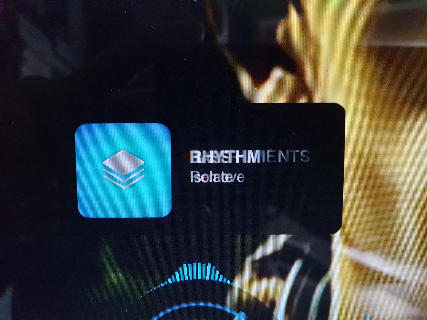

Here are some examples of how stem names appear in the live skin panel:
