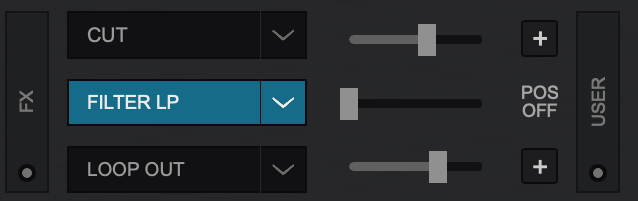

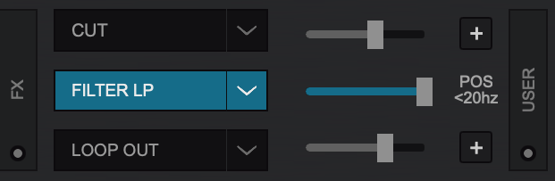

What I'm simply trying to do is activate the 'Filter LP' effect on a CUE point, and gently move the position of the slider on the effect from left to right in like 20 seconds (so it starts with 'Off' and at the end is should say "<20hz").
Effect at the beginning of the script:
Effect at the end of the script:
