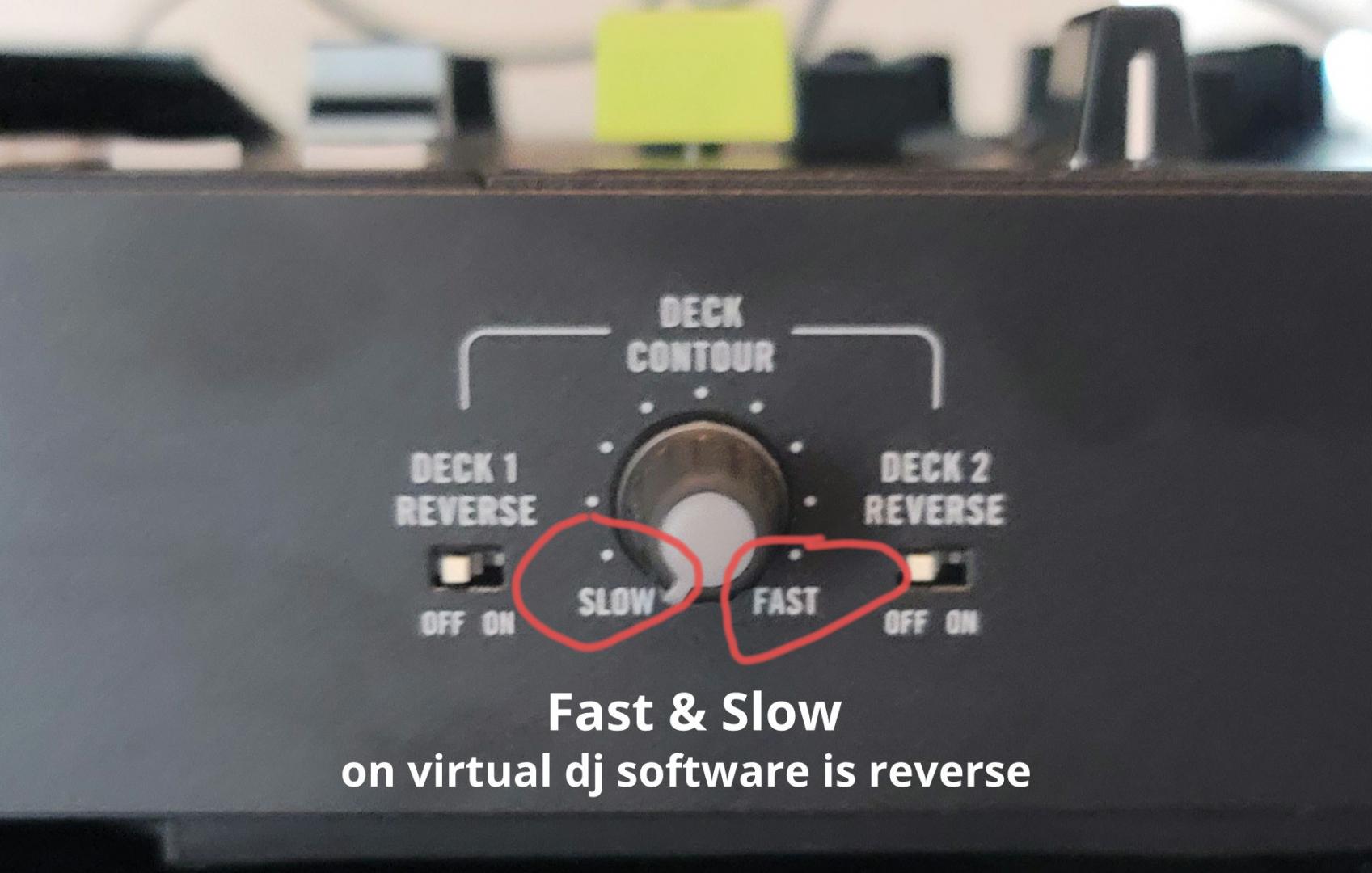

...Rane One...Has anyone else noticed the deck fader contour is reversed in software for the RANE ONE CONTROLLER. How can I fix the issue? Is this an issue that can be set nack to normal or re-reversed?
Posted Fri 23 Jul 21 @ 1:13 pm
looks correct as far as I understand it, slow is quadratic over the full fader, fast calls an inverted quadratic curve to get a fast cut in over a very short distance.
Posted Fri 23 Jul 21 @ 2:08 pm
Agreed, but the Volume on fader curve is reversed. When the knob is to the left the volume fade is fast (cut, for scratching), and the volume fade on the right is slow. According to the contour control on the controller what the software is doing is reverse order from what the controller's label is.
What I would like to have happen is the software/script action be programmed in the reverse order (so it matches the controllers physical label & contour control) so knob to left is slow, and knob full to the right being fast.
Posted Fri 23 Jul 21 @ 5:24 pm

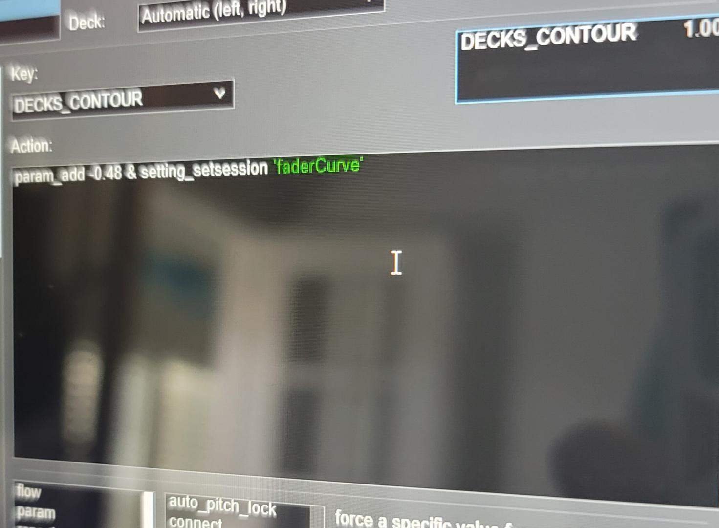

param_invert & param_add -0.48 & setting_setsession 'faderCurve'
Posted Fri 23 Jul 21 @ 8:23 pm
I will insert code and report back. Thank you
edit_ That solved the issue. Thank you
Posted Fri 23 Jul 21 @ 8:44 pm
devs will likely hotfix the definition file at some point, when that happens you can undo this edit
