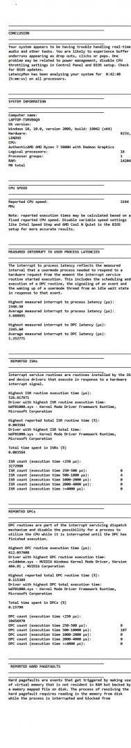

          So after about an hour i see red, highest measured interrupt latency 2348.50, so what do i look for now?
       Posted Sun 18 Jul 21 @ 10:49 am
          Did you get a drop-out?
2.3ms should still be fine since 512 sample latency would be about 10ms

          no, it was fine, so just because it says "Your system appears to be having trouble handling real-time audio and other tasks." does not mean i have a problem?
    Posted Sun 18 Jul 21 @ 11:16 am
          Only if the sound starts breaking up.
    Posted Sun 18 Jul 21 @ 11:20 am

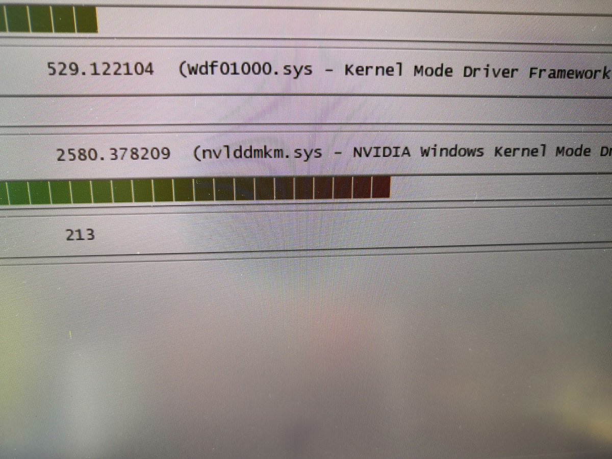

Might be worth running automix with Windows task manager running in the foreground to see if there's anything causing a CPU spike when the music skips. That's the first place I'd look.

          nv1ddmkm.sys
