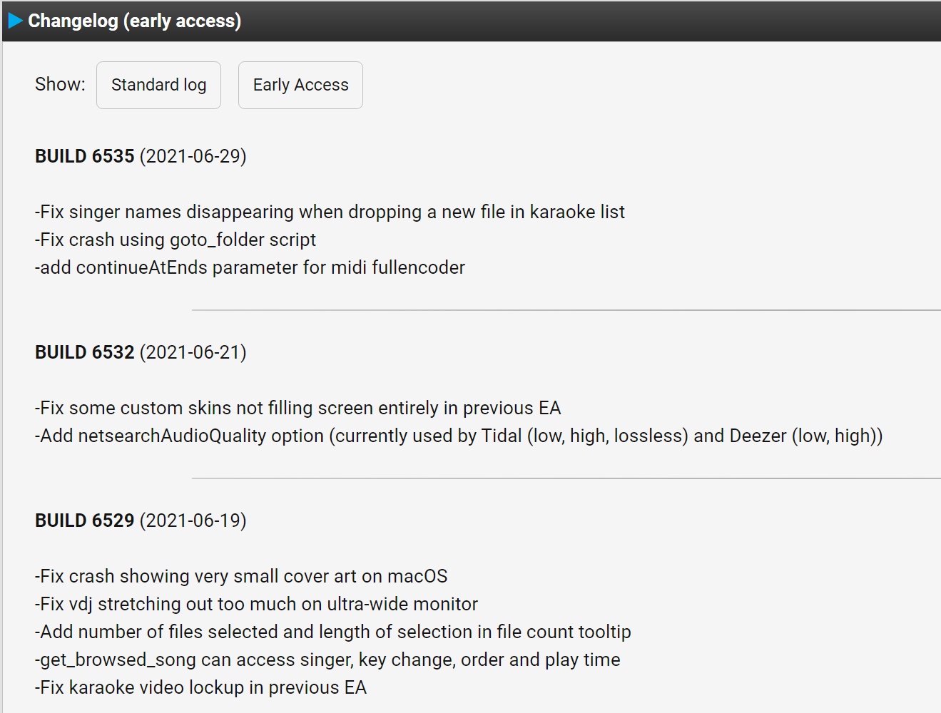

Well at least for god sake tell people you've made that change. I agree with it as I've highlighted that issue before.
I'm absolutely sick of you making modifications and not listing them in the changelogs. Not professional at all. Why does this keep happening?
@Adion?
@Adion?
Posted Wed 30 Jun 21 @ 6:45 pm

I get it but why did Atomix change things without appending the changelog? Why bother with it at all?
Posted Wed 30 Jun 21 @ 7:46 pm

It was a check that was supposed to only affect the slowest cpu's that would not be able to use stems effectively anyway and could therefore even lead to audio dropouts.
It did affect a bit more powerful dual-core cpu's as well which was not intended.
It only affects the automatic selection though, so as said in this topic it is still possible to manually select mathEngine and precomputeStems option. (And if you did have a manual selection before this update then the setting was not reset either but just kept the manual selection)
Anyway, the check has been reverted in build 6541 currently in EA and will soon be public as well.
Sorry for the inconvenience this has caused.
Posted Thu 01 Jul 21 @ 10:59 am
