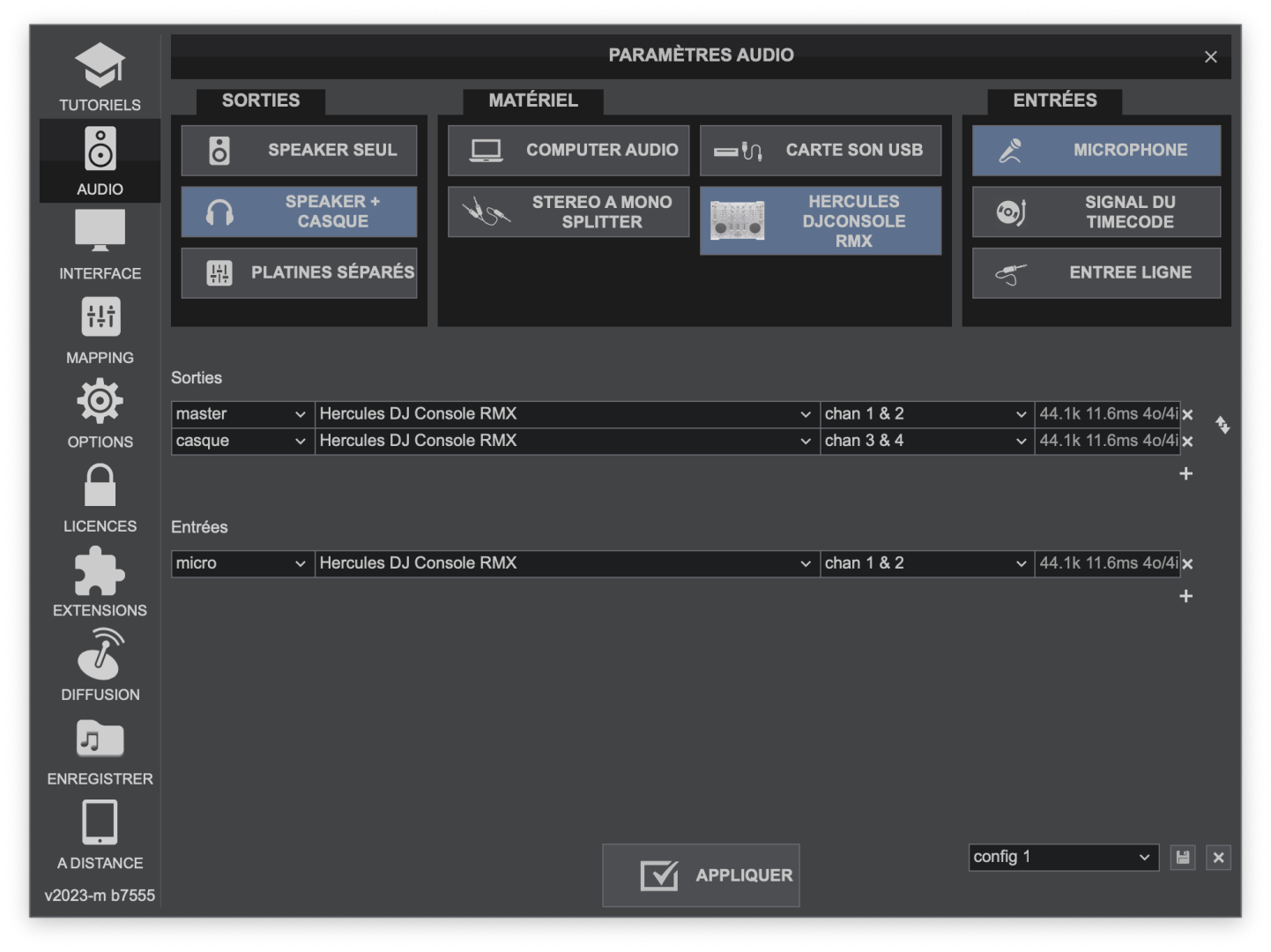

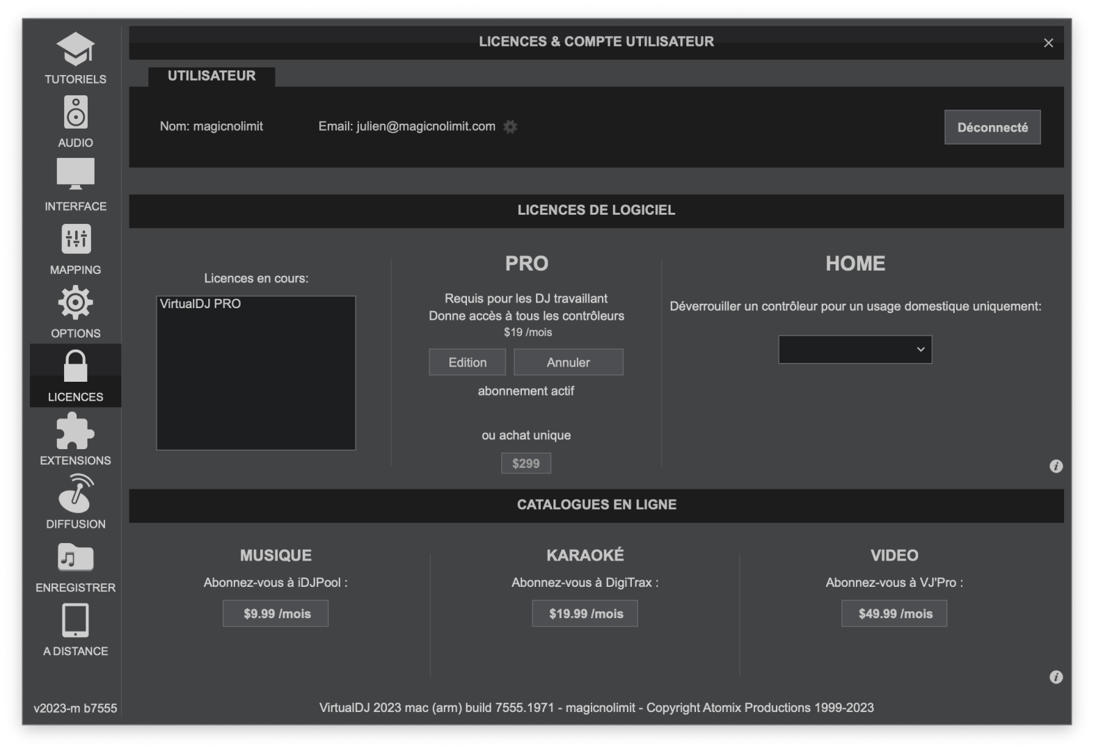

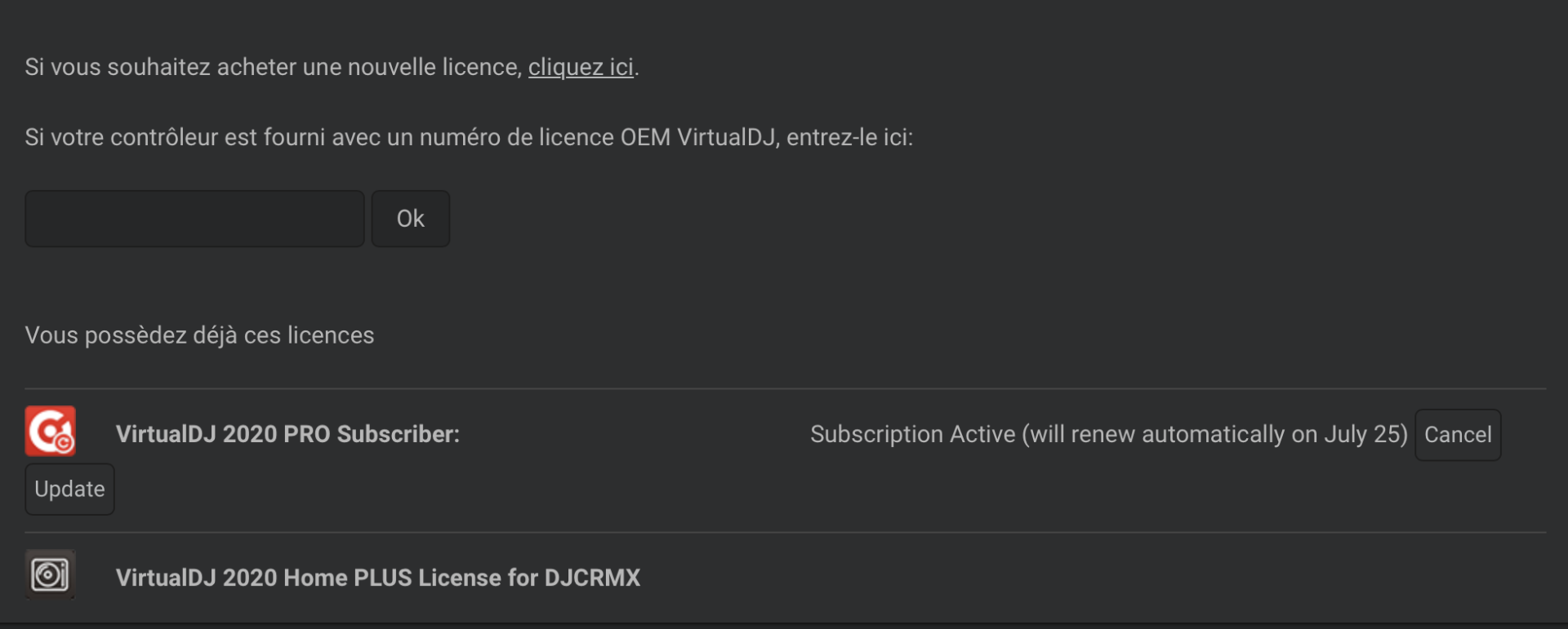

Hi everyone, if someone can help me.
I did all they recommended, reset, settings, download, re install.
I can see my Hercule RMX sound card and use it as the sound goes to my speakers through the main output, but I cannot control the Virtual DJ app with the controller, and no sound in the headphones.
When I move the sound, high, medium, spin wheel,... any button of my RMX controller respond ;( to my computer, no order send.
And you can see some screenshots of my computer, to help you understand.
When I was using Virtual DJ HOME PLUS License (paid already) was working, but now not at all, even on old Mac and old OS.
That’s why I ‘m thinking about a problem of compatibility …?
But despite the new license that I bought Virtual DJ Pro subscriber, I still cannot control anything.
See screenshots attached
If you have an idea... VDJ assistance send me to forum to solve my problem....

So,
1. you have properly (without any error) installed the latest drivers from Hercules ?
https://support.hercules.com/en/product/djconsolermx-en/
If so, check in Control Panel ->about and see if there is a firmware update available
2. Nothing to "allow" in System Settings -> Privacy & Security ?
3. Tried to enable what is called "system extensions" ? https://www.m3datarecovery.com/mac-bitlocker/enable-system-extension-m1-mac.html (you will need to repeat the drivers installation in this case)
4. Does Snoize MIDI Monitor detect your Hercules controller under Sources-<MIDI Sources ?
Install from here https://www.snoize.com/midimonitor/
The old Hercules controllers have issues with USB 3.0, and may require shorter USB cable and/or powered USB hub to work. https://support.hercules.com/en/kb/1006-en/
EDIT.
I dont have the RMX to test, but i tried to re-install the Hercules Drivers (M1 - Ventura). First thing i noticed is that in the installed components/Control Panels, the RMX was not listed.
After installation i go to Applications->DJHERCULESMIX->DJSeries->RMX->ControlPanel and the folder is empty , there is no app there.
So probably the RMX is not supported in Ventura and/or M1/M2
Better report the above to Hercules Support.
If Snoize MIDI Monitor cant detect the RMX as a MIDI device, neither any MIDI/DAW/DJ software will do.
Note that we are talking about the MIDI device, not its built-in sound card , which can use the Mac coreaudio driver (with limited functionality though)

EDIT2. In Applications->DJHERCULESMIX->DJSeries->Updater folder, there is a "manual_update" and "updater" app, along with some RMX related files. Maybe you can try to run one these and point to a dja/djc file to do some firmware update, but there is always a risk when you manually do firmware updates, so perhaps still best to ask Hercules before doing this.

It seems to be there is no solution even for my case. DJ Control MP3. This means i need to to stop the pro membership. It is very disappointing because you are forcing me to pay the membership and then finally there is no solution to get the device running. But you listet it as supported.
Posted 7 days ago @ 11:03 am
Or you can look at the situation the other way: your Pro membership allow you to use an impressive list of DJ controllers, a lot of them you can probably find second hand for pretty cheap on.
Some of these controllers came out a while ago, and as much as we like seeing our users still having fun with them after all this time, incompatibilities are unfortunately out of our control. Maybe you can pass it on to a kid in your area, which will still be able to enjoy it on an old computer.
