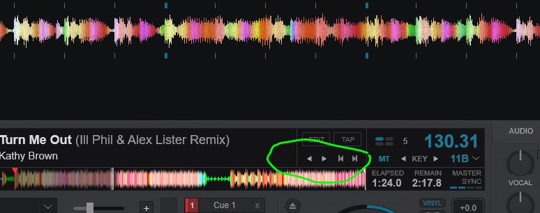

Hello I would have made a better thread title only I'm not sure of the names of what I'm talking about, but anyway...as per this image
https://ibb.co/2dYwWNq
I want to line the part under the read arrow up with the part under the yellow arrow(cue point) I can do it in serato but can't figure out how to do it on virtual dj.
any help would be appreciated

CBG calculated beat grid
click the bpm value
use bpm editor
or if paused line up the actual beat with the playhead and use tap.
there is another incremental adjust
adjust_cbg -0.01
adjust_cbg +0.01
click the bpm value
use bpm editor
adjust_cbg -0.01
adjust_cbg +0.01
You can click the bpm display on deck and it will open an adjust grid panel where you can adjust those beatgrid dots
Posted Sun 16 May 21 @ 12:57 pm
You can also cue up to first beat, and click the "TAP" button same place ..
to start/align the beatgrid from that downbeat
