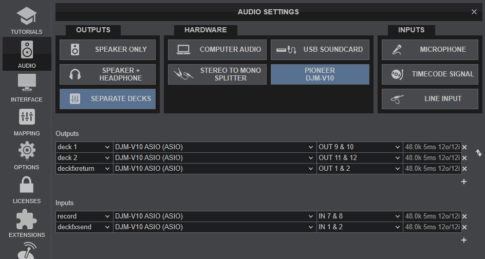

I am using a Pioneer DJM-V10 with VDJ, as is a friend. I have a Windows 10 machine and she is on an M1 Mac. We are both encountering the same issues:
* Deck 1 goes to CH2 on the mixer (channels 3 & 4)
* Deck 2 goes to CH4 on the mixer (channels 7 & 8)
--- This is _somewhat_ mappable, but really, this is many problems, and the deck<->channel mappings are not reliable nor fully consistent. (This is not due to OS Sound Card issues. I'm a developer of >20 years, as is my colleague, and the audio card driver is operating and reporting correctly.)
--- This does seem related to VDJ writing mappings on first load with the controller, which we were both connected simultaneously at first. This above was fixed for my colleague by completely reinstalling the software. I have not re-installed and would prefer to fix my mapping.
* Intermittently, the wrong fader will control the wrong mixer channel, seemingly typically fader 3 controls channel 4.
* The knobs control strange things. Mixer CH2 knobs may control CH1, or sometimes even control completely different mixer channels. We eventually got this down to the "extra" knobs that VDJ gives us. We sadly had to turn this functionality off because it cannot be reliably controlled nor predicted. Now the knobs mostly always controls the CH they are physically on, except when they don't and instead control a neighboring mixer channel, such as is the same with the fader issues.
* Sometimes the software allows us to set the decks -> channels correctly, but this often results in no audio through one of the mixer channels, even though there are LEDs on the mixer indicating it's receiving audio
* VDJ seems to override the mixer, as we had output on mixer CH3 when the fader was completely down: there should absolutely not have been any output. The only way to cut the audio in this case was to turn down the master volume on the mixer itself.
* MUTE - there is the strangest intermittent MUTE issue. It seems related to when the Channel input selector is switched, but the VDJ is not reliably knowing which input is being used A or B, and channels are being muted when there are far more than enough channels available for routing. We tracked this down to a mapping in VDJ which is trying (with broken logic) to determine which channel to MUTE. This is frustrating and should not occur. Please don't MUTE decks on my behalf, especially not in a way that can be overridden in the interface.

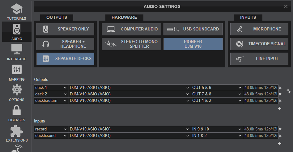

To pre-emptively answer some troubleshooting questions:
* Yes we are using ASIO in windows and Core Audio in Mac, with the DJM-V10 as the audio card.
* We have tried it individually and together. Sometimes we can get it to work if only one of us is using the controller, however this does defeat the purpose of having a 6 CH, dual audio card, mixer.
* We have tried a variety of deck-channel mappings and when it works is very intermittent.

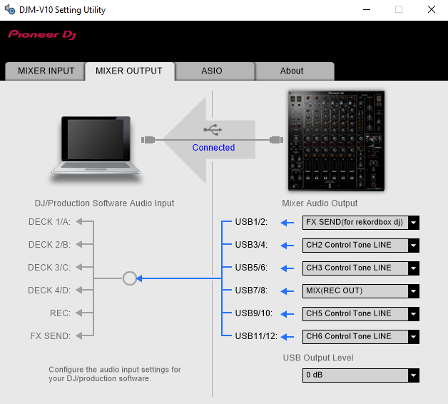

I want to add that we are well familiar with how to use the mixer as an audio card and how to route audio (in other applications) to different channels and how to use the Pioneer driver and hardware to split the channels between two computers, as well as routing audio from DAWs and DJ software.
The channel input knobs are switched to the correct USB input in all cases, whether we are using the mixer singly or dually. In all cases when we are both connected, one or both of us has a whole deck that we cannot use because it is incorrectly MUTE-ed

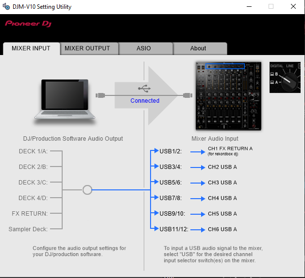

First, even though it's a 6 Ch mixer, Pioneer has somehow limited the Decks to 4, by using the last input/output pairs for FX Send/Return, Record and Samper output, so we followed their proposed way - and not much we can do about it.
On top of that, despite the fact that the channels are numbered 1,2,3,4, by default we use the Mixer Ch Order 3-1-2-4 as shown in the manual https://www.virtualdj.com/manuals/hardware/pioneer/djmv10/mixer.html
With default settings and setup, doesnt it work correctly for you as per the manual ? Do you wish to control the decks in a different order ?
By default Deck 1 (Left) should go to Mixer Channel numbered as 2 (Audio Output channels 3,4) and Deck 2 (Right) should go to Mixer Channel numbered as 3 (Audio outputs channels 5,6) on the DJM
BTW, the more you mess with the setup (Audio, mapping etc), the worse will become for you if you dont know what you are doing. Better explain what setup you want to have and we ll guide you.
Honestly the definition (internal mapping) wont help you, and thats the reason we avoid to provide to users.

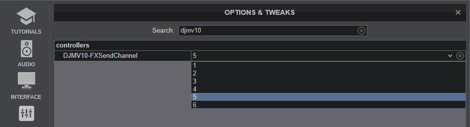

user23763514 wrote :
... as Virtual DJ is insisting on use of channels 2 and 3, and not allowing use of 4 & 5.
You still have not explained your desired setup.
VirtualDJ doesnt insist on using channels 2 and 3 (for Decks 1 and 2), but indeed it's the default. You can change the MixerOrder setting and change from 3124 to 1234.
Channel 5 is by default used for FX Send/Return and cannot be changed.
Channel 6 can be used as "Deck 5", if you replace the "sampler" with deck 5, and even its input if you don't care recording.
Again, need to understand your desired setup. Is it just one DJ who wants to use 5 or more Decks and with some specific Ch order ? Or is it 2 DJs trying to both mix live with 2+2 or more Decks ??
If you give me more details, i will be able to find a solution for you.

But before doing that there is one principal that we (VirtualDJ) cant ignore and/or bypass.
In order to get all the features of the hardware/firmware, we need to "unlock" what is usually called "Rekordbox|Serato mode". In case we skip this step, several features (such as DVS inputs, BPM passed to firmware etc) will not be available.
When you enter this "mode" you have to select one of the 6 available pairs of Inputs (outputs for VirtualDJ) as FX Return as you see it in DJM-V10 Setting Utility. You cannot ignore this setting, or else the firmware will auto-select one , so u really cant skip this.
By selecting one of the 6 pairs of outputs as FX Return, your mixer becomes a 5 Channel mixer and u cant do anything about it.
Why ? Ask Pioneer. Obvious reason is because both Serato and Rekordbox only support up to 4 Decks and thought it would be a good idea to have Post-Fader software Effects.
One thing that u can do though, is to customize the Channel routing, including the FX Send/Return channel. You can choose any of the CH (1 to 6) to be the CH to "sacrifice" as FX Return. This information is also available in the manual , but since you hate the RTFM, i thought to write this here too..
Based on the above information, will try to provide solutions to your case-scenarios.

That being said , the most important thing to take care here, is the Audio Setup in VirtualDJ and the DJM V10 Utility.
For the examples above,
a) Audio Setup needs to be ..
and DJMV10 Utility needs to be ..
Notice in my example that i used In and Out Channels 1,2 for FX Send/Return, but you could choose any other from the available, and that i assigned the Record output (input for VDJ) as channels 7,8
Example b)
DJMUtility will be same as above with the exception that the USB 9/10 needs now to be assigned as REC (OUT)
I could go on and provide more examples, but i guess you understand the concept.
