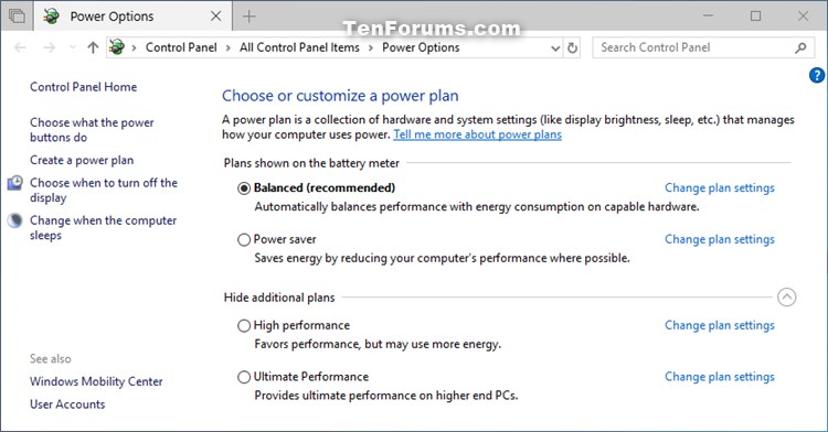

And can also try set Windows to max performance, and not run on battery.
https://www.tenforums.com/tutorials/2843-change-power-plan-settings-windows-10-a.html
