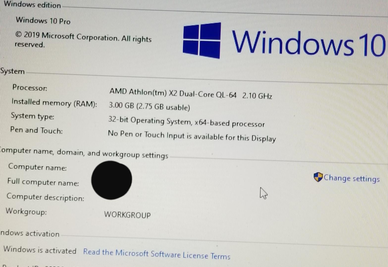

i have this kind of laptop and i use him only for DJing

It's a 2009 processor, 32 bit windows and very little RAM.
It's probably struggling to decode 2 HD videos at the same time.

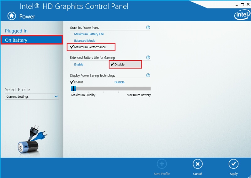

Can try update the graphics first, to see if its up for the task.
And guessing its an onboard intel graphic, set it to max performance in the intel settings

Depends... if its Intel, or if the AMD has on-chip graphics (or not at all)
So IF you have intel graphics, update drives first here
https://www.intel.com/content/www/us/en/support/detect.html
Then set to max performance and disable power saving in the intel control panel

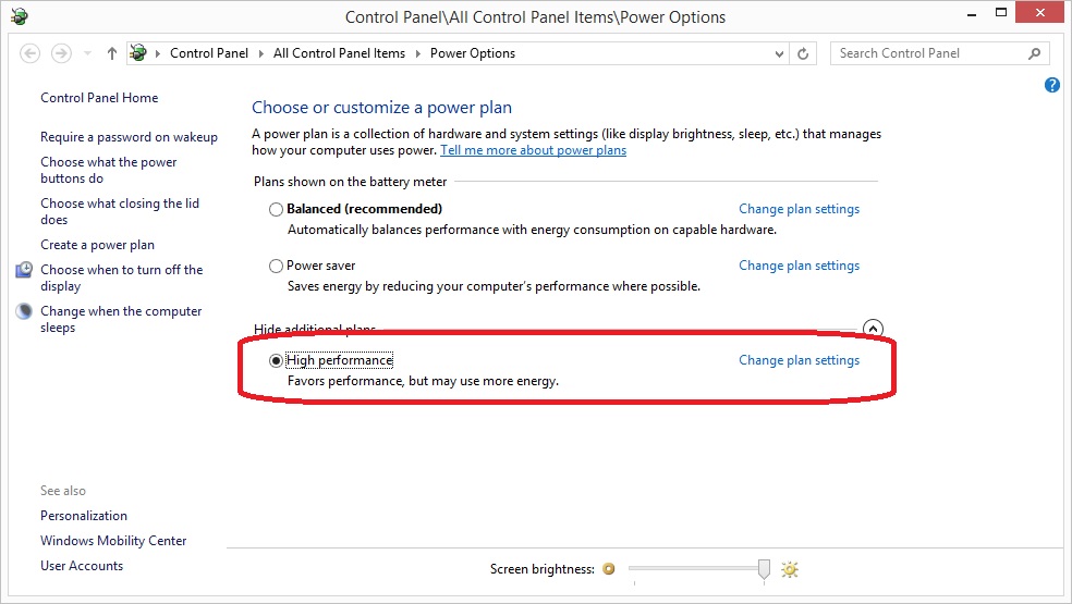

You can also set the power management in windows to max performance, might help a little...
You do that in power options at Windows control panel
