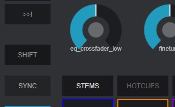

Thanks to Nicotux I have a controller button for permanent shift and for temporary shift.
The LED turns green while the shift is on.
But if I then turn off the shift with the mouse on the screen (the shift button of the skin), the LED stays on, although shift is off.
Generally speaking, the LED of the controller does not respond to the input on the skin.
How can I change the script to get the LED responding to the controller AND the skin-based input ?
Thank You for helping in advance
repeat_start shlk ? on & repeat_stop shlk & shift off : shift ? on & repeat_stop shlk & shift off : repeat_start shlk 170ms 3 & not shift ? shift
shift ? color green : black

Do not understand exactly.. where is the SHIFT button on the Skin?
Do you mean a custom button with your posted script ?

the shift button is the button with the script ^^
