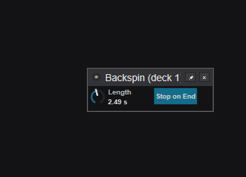

In the backspin fx settings, there is a button to select if you want it to stop or not
Posted Fri 16 Apr 21 @ 12:55 pm
Perfect, thank you very much
