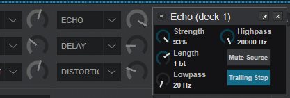

Perhaps you want some Echo Trailing ? If so, the Echo FX has a button to enable that (in its FX GUI) ..
