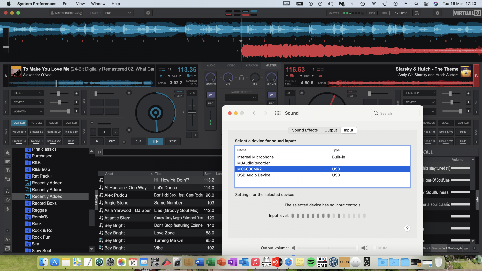

Just done some more testing what I have noticed is I am getting equal coverage now over mic and music but there is no volume adjustment on the output when broadcastingon the volume is very low on the server coming through quietly
on the Mac that does the broadcasting there is no way to adjust the volume levels on the input and cannot just the levels on Virtual DJ the audio section in the middle square master/Mic/mix and volume are set to maximum
where can I turn the volume up more from please
/Users/markburton/Desktop/Screenshot 2021-03-16 at 17.20.55.png
Posted Tue 16 Mar 21 @ 6:41 pm

As it's a mac I may not be much help - and I'm not that familiar with broadcasting except through Zoom.
I don't quite understand how the sound is being routed? Can you show a screen shot of the VDJ Audio config.
If the Sound Input for the mac is the MC6000 - then would that be Mic input going directly to the computer sound without going via VDJ?
The setup I have used is routing the mic into VDJ, and then using a virtual cable to route the VDJ master output (which will include the mic) into the broadcast - in my case using zoom.....
Posted Tue 16 Mar 21 @ 7:28 pm
