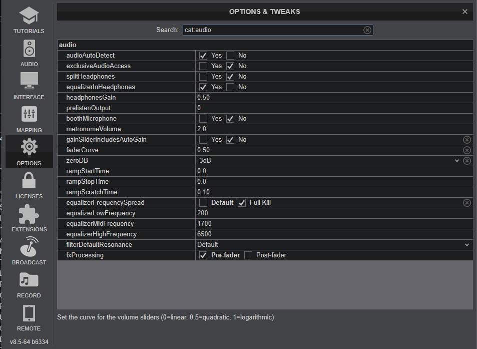

Try to set zeroDB to a lower value (from VirtualDJ Settings->OPTIONS tab)

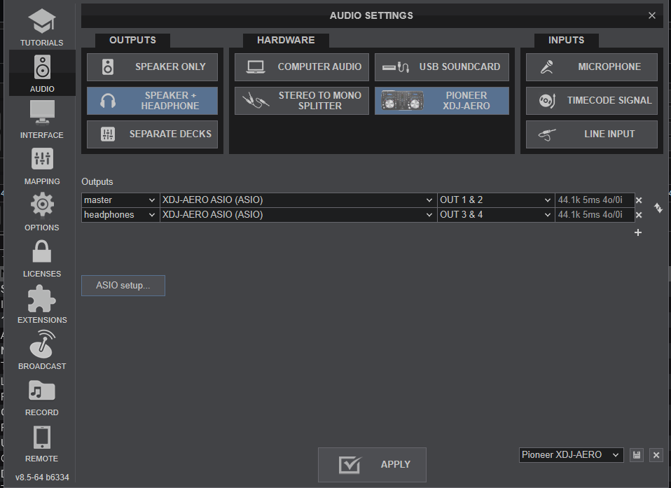

Your Audio Setup in VirtualDJ is just Master & Headphones ?

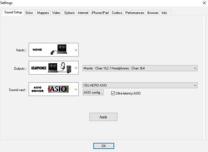

I don´t know where is a mistake, when I used VDJ 7, it was fine.
Your Audio Setup in VirtualDJ is just Master & Headphones ? yes and XDJ Aero from Pioneer.

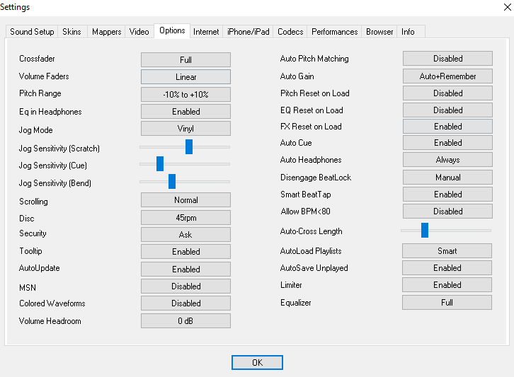

autoGain: set to Auto+ Remember

In VirtualDJ 8 (2021), try
autoGain to Auto not Auto+Remember.
gainSlidersIncludeAutoGain to Yes
crossfadercurve to Smooth
Re-analyze a few tracks, load, mix, record and check again

I try it. But the sound is not good. Could be problem with EQ in VDJ2021?
The setings are same in VDJ7 as I sent and in VDJ2021 I did it as you recommand.
