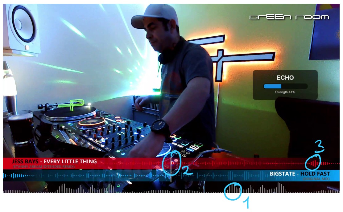

I'm using VDJ to render my videos on YouTube. I use the webcam plugin to capture myself from different angles and have a customized video-skin to show the actions I'm doing and the currently playing songs.
It looks like this:
My issue is, that the webcam renders with like 160ms - 200ms delay. This looks strange when doing fast fader moves, because then the sound does not fit the picture.
So I decided to add a render-delay for the sound in OBS. This works well for the pure webcam signal. Sound and webcam sognal is in sync now. But now the video-skin overlay isn't in sync anymore. For the equalizer (1) and the waveform (2) there is a delay which looks strange again.
My question is: Can I either add a render delay for the video-skin overlay only or can I make the webcam-plugin render the picture "more realtime" without a delay or with a minimal delay?
