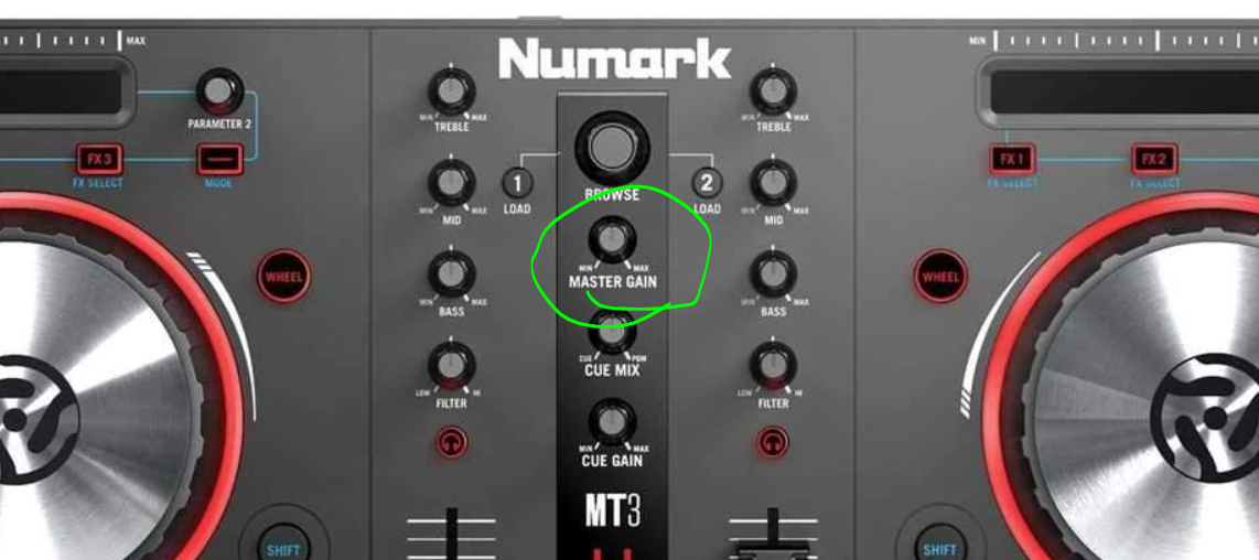

1) When you are playing through controller, you adjust the volume on the Controller itself.
2) When you are playing without the controller you can use PC volume (as you said, and that part works for you already)
So for #1, is your speakers connected to the controller then?
If so, just turn up master volume on the controller, and make sure volume and master volume is up in the software as well.

And if you have speakers connected to the mixtrack when using the controller, use the master knob in middle of the controller

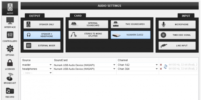

My controller doesnt have a soundcar built in.. I am in my settings now and cant see my laptop speakers In the Dropbox?? Just the speakers I have auxed to my laptop and the same is happening very quite wen played... this all happens wen I plugged my djio numark audio interface in could this be something to do with it..
Posted Wed 24 Feb 21 @ 12:39 pm
Ah yes, you have the Mixtrack 3, not the Mixtrack Pro 3 (that has soundcard inside)
So you are using DJ iO? or built-in PC speakers?
You just have to adjust volume where you have routed the audio.
Sounds like you are using both scenarios.
PC speakers without controller (AND DJ iO sound card) works loudly and fine.
So when you connect the DJ iO, the volume out of that sound card should be controller by VirtualDJ (and not PC speaker control). If your speakers are connected to the DJ iO soundcard.
Or are you just using the DJ iO for headphones?
All depends on what sound card settings you have and where speakers are connected.
Perhaps post a screenshot of your sound settings ;-)
Posted Wed 24 Feb 21 @ 12:41 pm
baz1991Home userMember since 2021
I am currently waiting for rac cables to get delevired to use my dj io ... so whilst I wait I just want to play it thru my Bluetooth speaker what I have connected to my laptop with a aux cable...i did try the djio the other day to see if worked and i think it automatically set its self up to my virtual dj audio settingsa .... how do i send a screenshot on here ???
Posted Wed 24 Feb 21 @ 12:50 pm
If you dont have cables for the DJ iO i guess you dont want to use it yet?
If so, just let it be until then ;-)
Connecting hardware will often automatically change the sound settings in VirtualDJ
After doing so, simply go to VirtualDJ sound settings, and change master back to your bluetooth speakers.
That should do it ;-)
