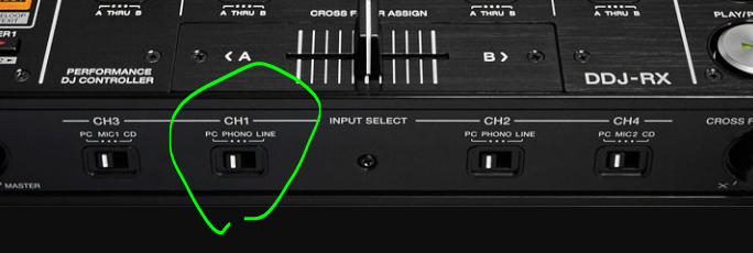

I dont have the RX, but think you might have used the "wrong" channel, from quick look at it. But could perhaps also work on the channel you did use.
Try use ch1 or ch2 for phono (or ch3 or ch4 for CD, if the timecode is that loud)
And make sure you change channel switches (at front) to the corresponding input intent

Do you have all Channel Inputs (front switches) to PC ?
Also, in Audio Setup, make sure you set the Timecode Inputs to the correct Channels, the ones you connected your TT at the rear.
From what i see, you have probably connected to CH4, and the CH4 Input at the front is probably not set to PC.
EDIT. From your video, it seems that the DDJ-RX sound card is detected as 4out/2in, so it's not giving the extra inputs for DVS. We will further investigate and provide a fix soon
