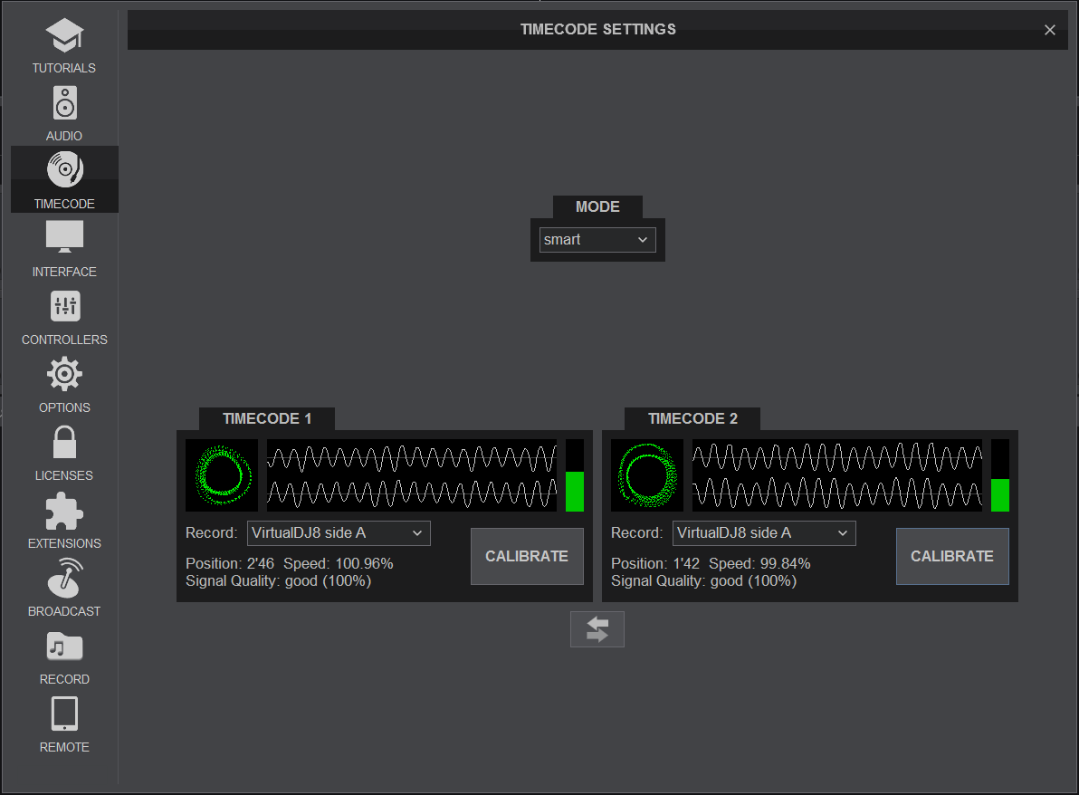

Did you set the DVS timecode mode to "smart mode"?
In this mode, you can apply software "overrides" and use more software features while using vinyls
Although depends on what you mean by "goes off beat", if this is over time slowly, it might just be wow and flutter of the turntable itself. Turntables dont rotate at a 100% precise rotation so there will be some drift. That you adjust by the center of the turntable or pushing / dragging the vinyl a tiny bit (even ride the pitch for small changes). Part of the charm ;-)
Also check the timecode calibration that the signal is good at a 100% ish signal with decent green circle indicated

Check the calibration of the signal.
If you are getting a good signal, and a nice looking circle.
With speed at 100% ish (when turntable is not pitched) and signal quality at 100%

Thanks but yes signal is great, pitch at 100% flutters up and down. Is that normal? I am starting to wonder if it is the decks.
I can say with 100% certainty one deck is faster, so that means I have to ride the pitch to keep it in sync. I THOUGHT the software would compensate for this fact - but it wont.

Try see if you can get a stable signal / speed by grounding the turntable, remove any interference etc
But could just be the motor that is having issues with inaccurate rotations
The software should override, needs a good steady signal.
Press auto calibration button in Timecode settings to try refresh the detection just in case.
If its a very noisy or vibrating enviroment you could also try adjust the timecodeSilence a bit higher.
