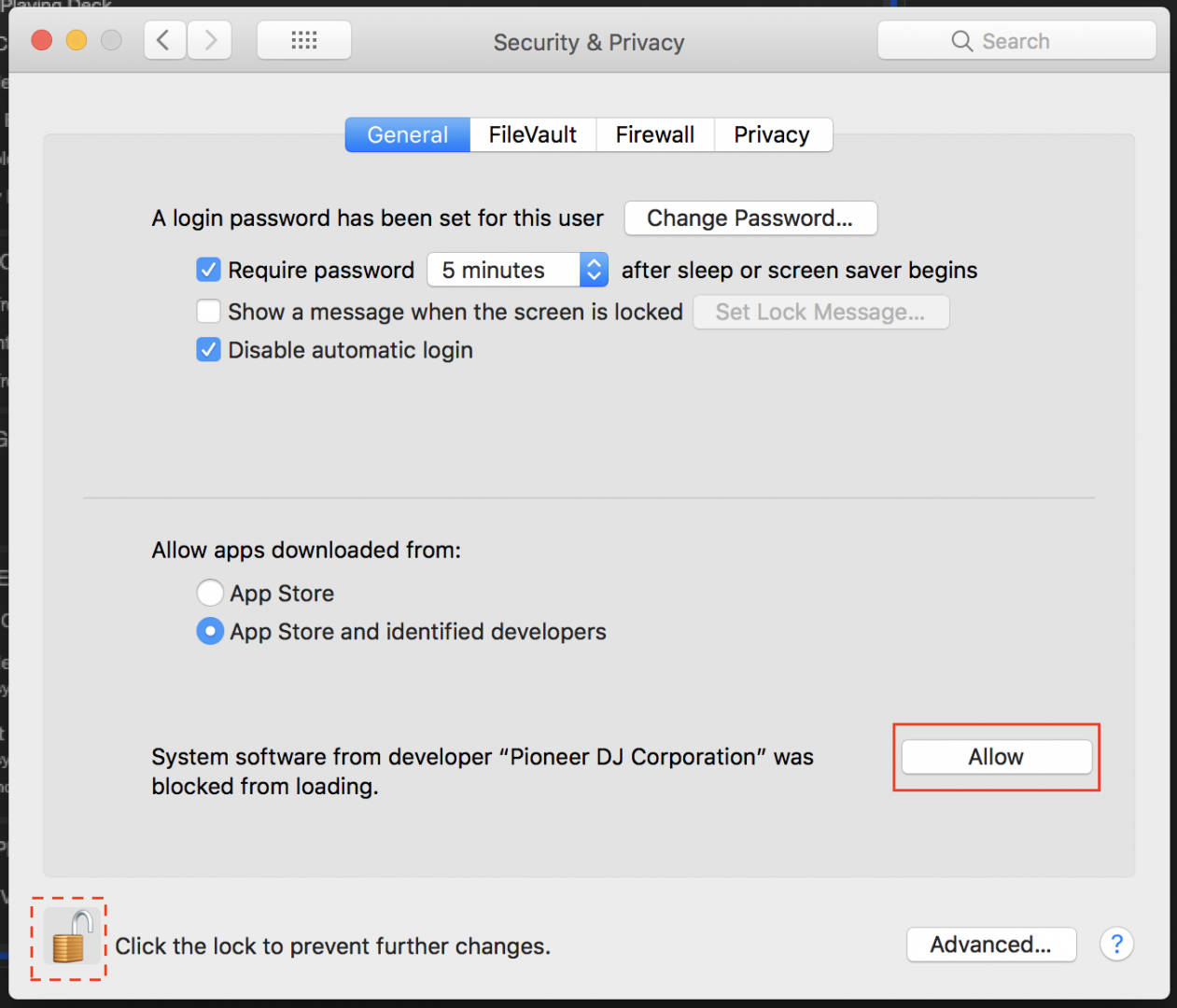

Hi Rune,
Thanks for that, but I have already done all this. I've successfully updated the firmwares and drivers to the most updated version, but I still have no control over anything. It's as if once I plug in my mixer to my computer, it sets all the eq knobs and crossfader to the left and I have no control over them. My computer still recognizes my SX3 being plugged in, but i cannot do anything from the mixer itself.
