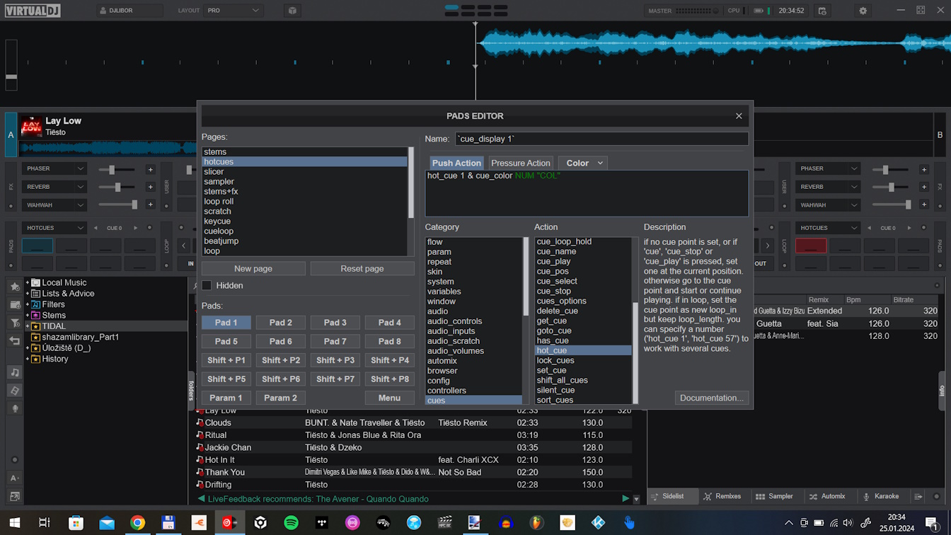

I'm very sorry @LOCODOG but I don't know exactly where to put the script. I tried it see picture but it doesn't work. Can you elaborate more please?
Posted Thu 25 Jan 24 @ 7:36 pm
well NUM isn't literal, it's a place holder, you could be on any pad number.
that pic you're on pad 1 so NUM should be replaced with 1
likewise "COL" isn't a colour
& cue_color 1 "white"
if you read some script advice and part of the script is ALLCAPS then read that as a place holder for a value
Posted Thu 25 Jan 24 @ 7:51 pm
You are putting script in the correct location.. and just need to tweak (specify the actual number and color) for the cue_color script.
click on the script, cue_color in the editor . and the description will guide you with examples.
For example: cue_color 1 'yellow'
Perfect, now it works as I need. Thanks a lot gentlemen!
Posted Thu 25 Jan 24 @ 8:17 pm
