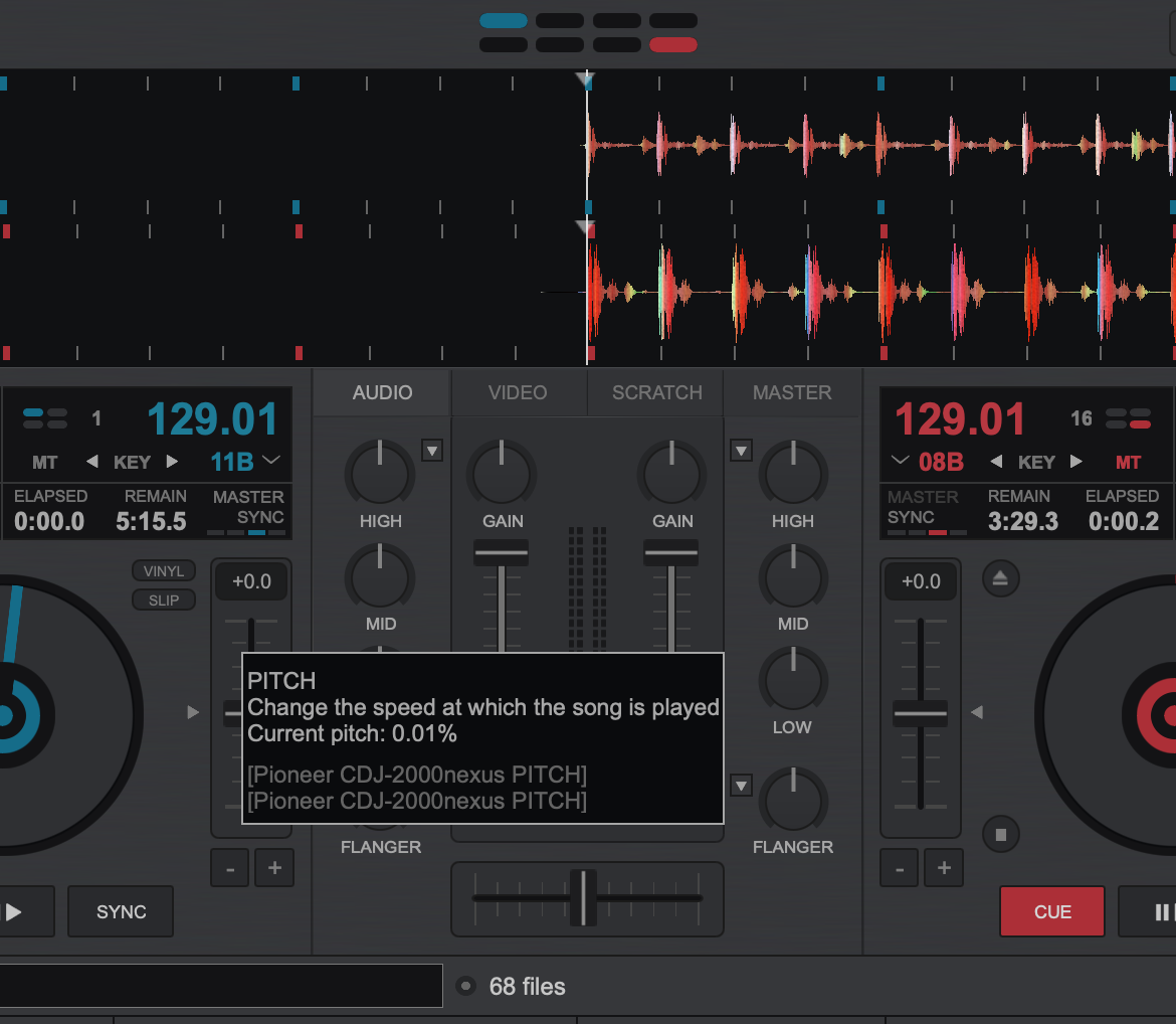

Northing happens. Also whilst the controls and knobs on the DJM work correctly, nothing on the laptop screen changes as in the controls all stay static on VDJ?

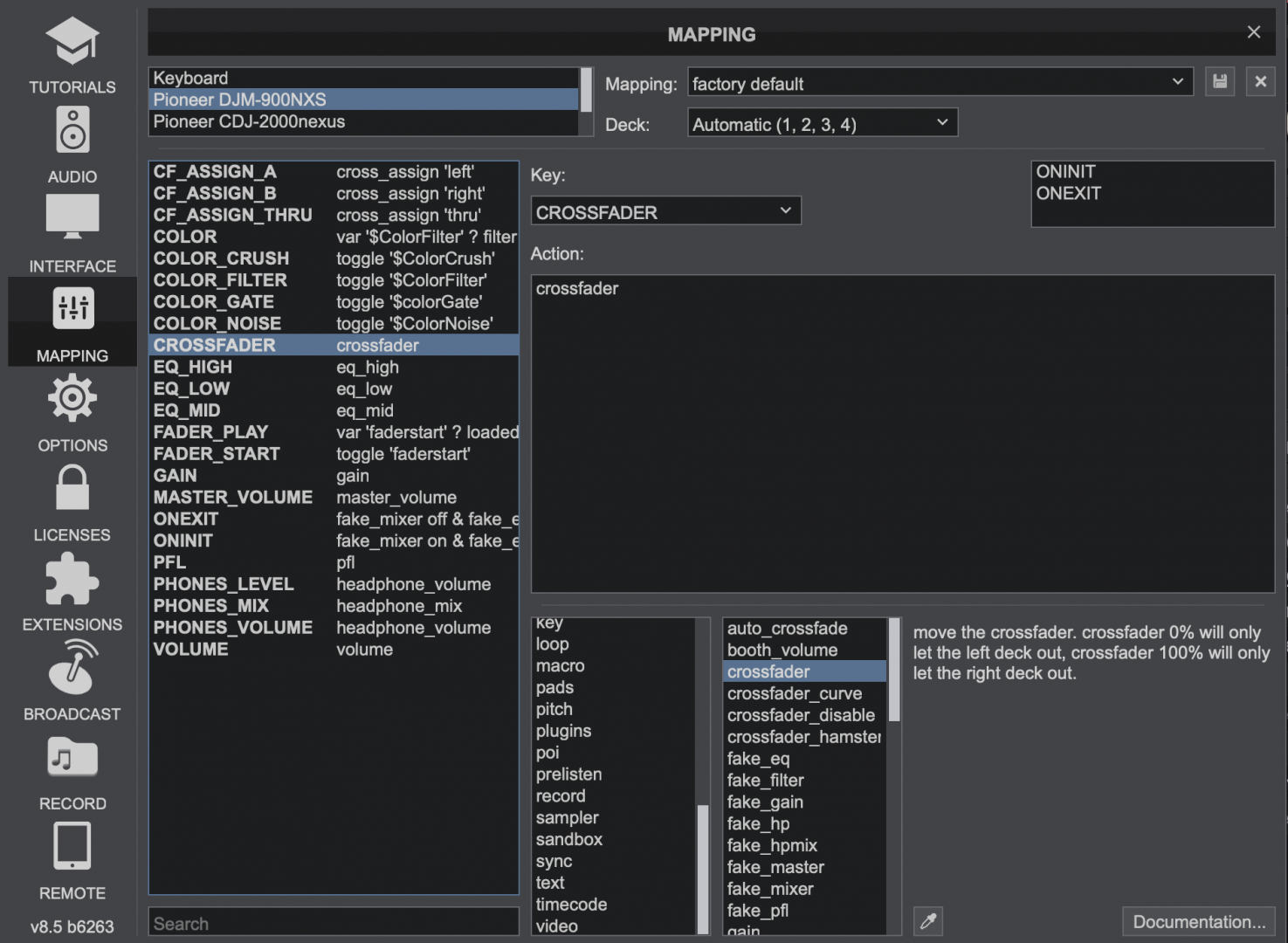

Do you see the DJM in VDJ Settings->MAPPING tab and the factory default mapping available (and selected) ?
When you move the Crossfader on the DJM, does the CROSSFADER key come up in the Key Learn area ?

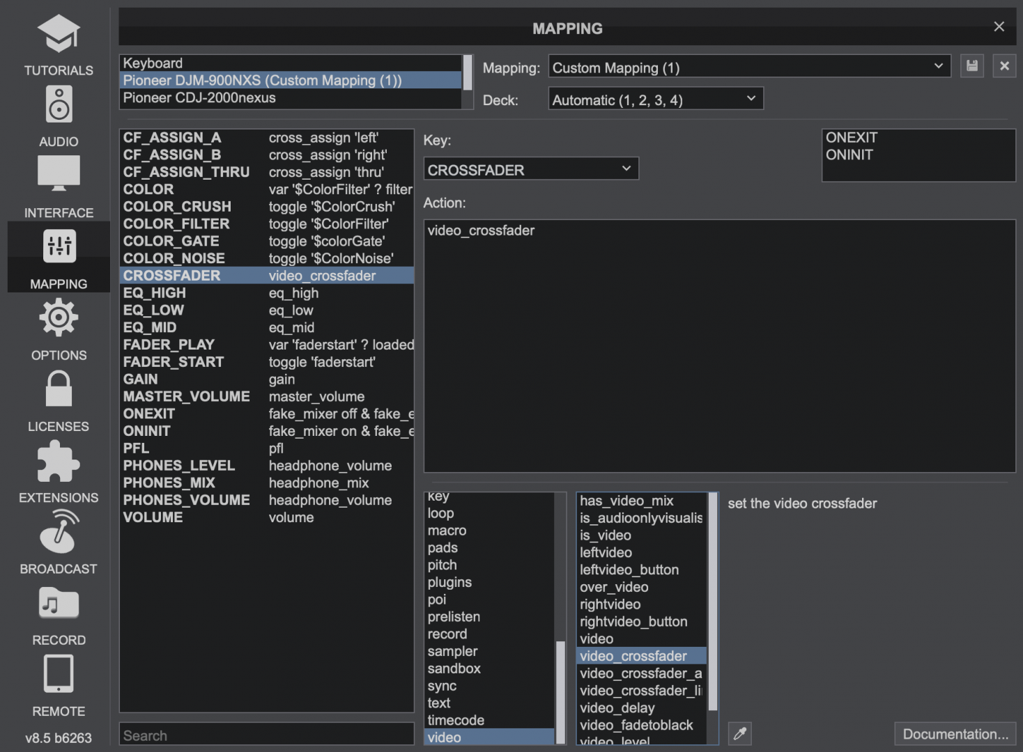

Your DJM crossfader needs to be assigned as .. video_crossfader and also set Video Crossfader to Manual

Factory setting is assigned to Crossfade
Custom mapping assigned to Video_Crossfader
Moving crossfader on the DJM does absolutely nothing to the display out
Also point that may be relevant or not, the channel faders are permanently up 100% on VDJ and do not move when i adjust on the DJM.
