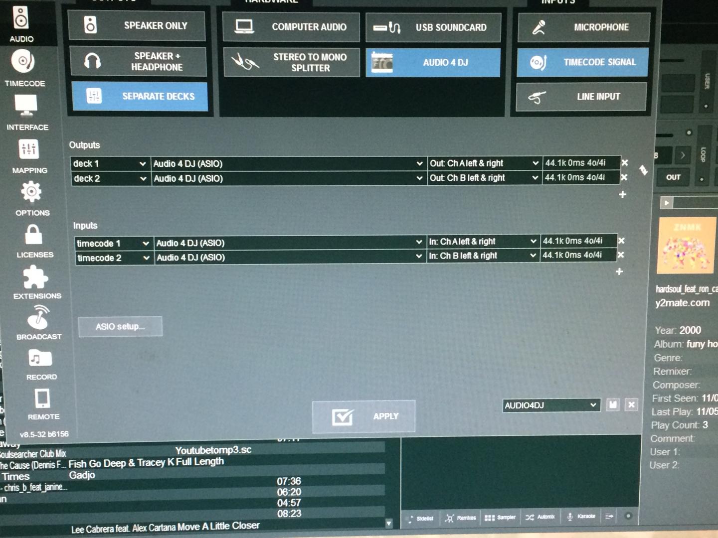

Hi I've purchased audio 4 DJ and would like to know how to configure it. Inputs out puts etc as when I go to Calabriate it it says no signal
Posted Mon 04 Jan 21 @ 3:24 pm
post a pic of your audio config
Posted Mon 04 Jan 21 @ 3:38 pm
Posted Mon 04 Jan 21 @ 3:49 pm

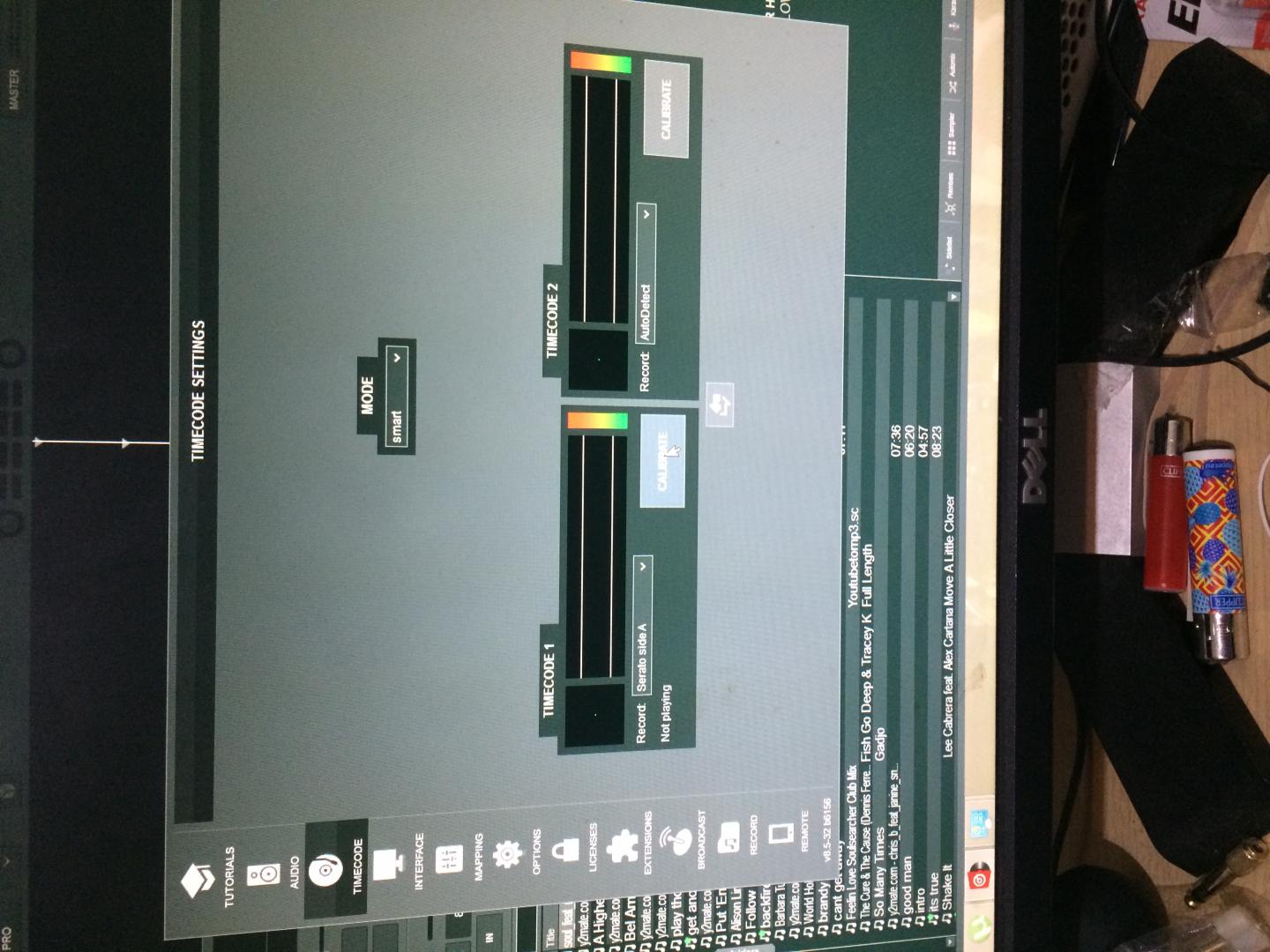

that looks right, what's the timecode tab looking like?
Posted Mon 04 Jan 21 @ 3:56 pm
Posted Mon 04 Jan 21 @ 4:00 pm
have you configured the device as phono inputs in the traktor utility?
Posted Mon 04 Jan 21 @ 4:08 pm
Where do I find the traktor utility the light on the audacity 4 DJ is lit up green on line. I bought this 2nd hand how to I change it to phono
Posted Mon 04 Jan 21 @ 4:12 pm
Posted Mon 04 Jan 21 @ 4:14 pm
And make sure you have wired it and connected it correctly.. .
https://www.virtualdj.com/manuals/virtualdj/settings/audiosetup/timecode.html
Posted Mon 04 Jan 21 @ 4:35 pm
Thank you. Got it working. It cuts out every now and then but guessing that could be computer or lead issue
