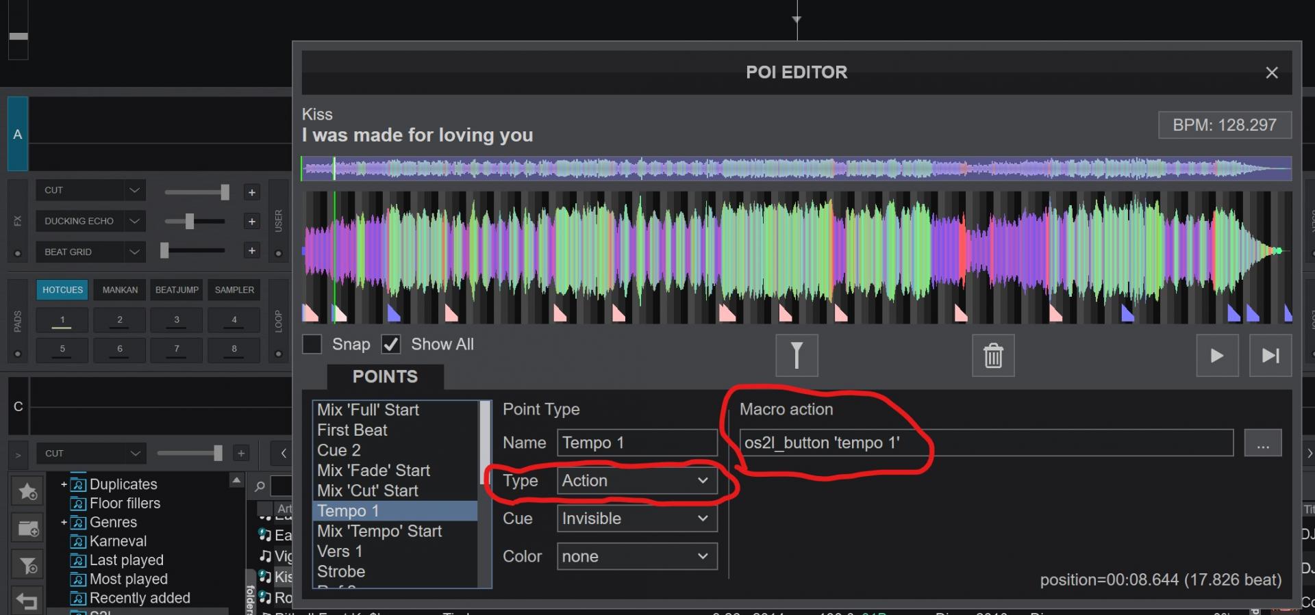

I´m running VDJ together with Showxpress (via OS2L) in order to have nice light-syncronizations for each track.
I wish that it would be as easy as you normally create a cue-point to even add these actions/macros as the picture shows.
This would then means that I can have a specific pad pages with different pre-defined actions/macros which with just a push on the pad-button would add it to the specific place on the track.
For those who use lighting-softwares together with VDJ it would save a lot of time and effort and even gives them new opportunities to create awesome mobile-dj setups.
In case you not consider to integrate a complete DMX-software inside VDJ (which I have seen have been requested) I think this is a really nice alternative to meet this kind of need/request.

I've spent a little time thinking on this, you can't set them on the fly [without the usual typing setting as action etc etc]
However you can set cues in such a way that you could do a find & replace on the database at the .xml level
I've got something here that found this
<Poi Pos="0.023946" Num="1" Color="4278190081" Type="cue" />
[any position, any numbered cue with a specific colour to know what action to turn it in to, single press and scriptable to set a cue this way]
And it replaces it with this
<Poi Name="OS2L" Pos="0.023946" Num="-1" Color="4294901502" Type="action" Action="MYACTION" />
[given any name you want, same position, turned into a marker, color can be anything I chose a white, action cue with any action]
If you're into OS2L and want to save some pain give me a shout
