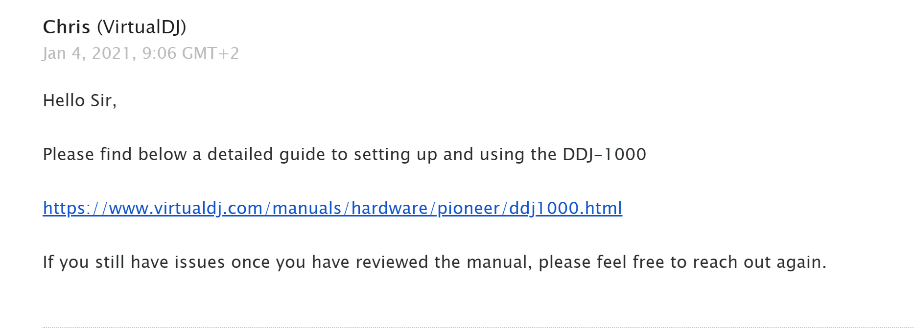

Unbelievable. Despite detailing out the issues and clearly mentioning that this is a bug in build 6240, this is the response I get from VDJ support!
Posted Mon 04 Jan 21 @ 7:31 am
Can‘t believe this.
Do they think we are noobs?
Iam really upset about this response
Posted Mon 04 Jan 21 @ 9:52 pm
