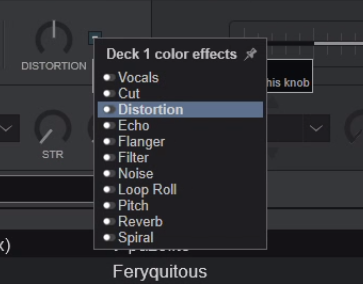

When DJs have simpler controllers plugged in (like an XDJ-R1, DDJ-400, DDJ-WeGo), everything works great and the Color Effects work normally controlled by the on-deck buttons, as depicted here:

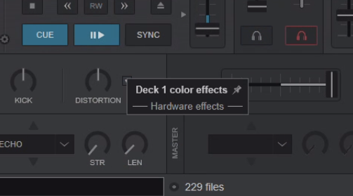

However, as soon as a DDJ-SZ is plugged in that has hardware effects processing, Color Effects on all decks are routed to the hardware processor and become inoperable since sound is going out via the computer:
Is there a way to prevent Virtual DJ from switching over to hardware effects when the DDJ-SZ is plugged in and stay on the built-in software effects processor?

fake_filter off
