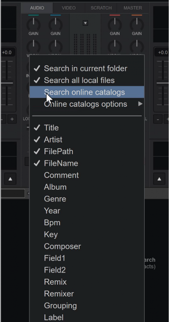

My next question is, how do I get VDJ to search my library instead of always searching the IDJPool??

Think I understand your question.
Change your Search Options, with the Dot to the right of the search bar in the browser.
Uncheck Search Online Catalogs, and/or change Online catalogs options to your preference.

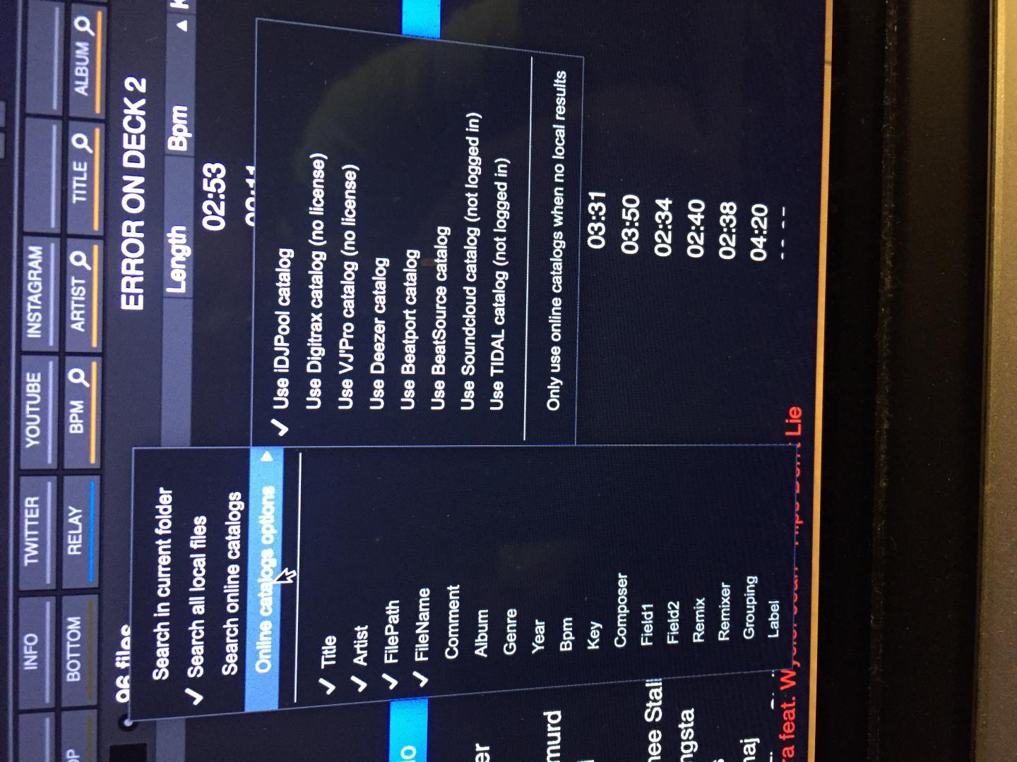

I have that unchecked and then I don’t get any results from my library even tho I know I have the tracks.
Also I can NOT uncheck the IDJPool.
Can anyone help??
Can anyone help??

So it should only search my local library with it setup this way, correct??

Should work, works fine my end.
Make sure you select other provider FIRST before you try uncheck iDJPool, since iDJPool will default if you have no subs at all ;-)

Why do u have "Search in current folder" unchecked ?
Any chance you have from Browser Options->Show Only ->Show Music|Video|Karaoke any selected (filtered out) ?
Well the “Deezer” folder is just playlists, there’s no actual tracks there. So I thought I’d try and uncheck it to see if it helped but it didn’t.
