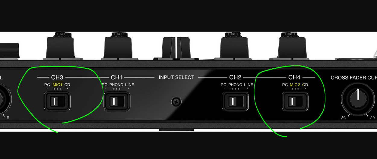

The mic on the SX require the "Record" entry part in the sound setting (if you are using the mic connected to the SX).
Did you add that?
The mic usage on the SX is perhaps not super intuitive, its on channel 1 and channel 4 on the mixer (and in hardware "only" direct to the speakers as well as to the "Record" loopback in sound settings for record and broadcast).
You switch that on the front of the mixer...
Alternatively you can use a mic connected to computer (usb/pc sound card) instead, and set up mic in the software...

Did you add that?
See here for that: https://www.virtualdj.com/manuals/virtualdj/settings/audiosetup/microphone.html
