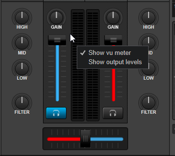

Hi do you know when this option will be added to the current skin vdj 2020 and 2021 ? I have an open ticket but i have no news

It selects if the vu meter shows the level before the level fader (as default with most mixers) or after (so it will show silence if the level fader/crossfader is down)

There is no plan currently to add this in the 2020 skin, it is however not very difficult to modify the 2020 skin yourself and change this.

I have add it in my Skin , I can change it in the Mixer Options (little Button over the Crossfader).

This is not something trivial, needs some work
here is a generic example of the structure (extracted of 8 decks skins) of the mod :
<define class="vb_vumeters" placeholders="*x,*y,*width,*height=[WIDTH]*4,*deck=0,chan=">
<group name="vumeter[DECK]" x="-[WIDTH]/3+[X]" y="[Y]">
<square x="-5" y="-5" width="[WIDTH]*5/12" height="[HEIGHT]+10" color="vb_vumeterbg" radius="6" />
<menu width="11+2+11" height="[HEIGHT]+10">
<item text="Show vu meter" action="skin_panel 'vu_output[DECK]' on" check="skin_panel 'vu_output[DECK]'" />
<item text="Show output levels" action="skin_panel 'vu_meter[DECK]' on" check="skin_panel 'vu_meter[DECK]'" />
</menu>
<panel name="vu_meter[DECK]" group="vumeter[DECK]" visible="no">
<visual source="deck [DECK] get_vu_meter_left [CHAN]" class="vb_vumeter" width="[WIDTH]*5/12" height="[HEIGHT]"/>
<visual x="+13" source="deck [DECK] get_vu_meter_right [CHAN]" class="vb_vumeter" width="[WIDTH]*5/12" height="[HEIGHT]"/>
</panel>
<panel name="vu_output[DECK]" group="vumeter[DECK]" visible="yes">
<visual source="deck [DECK] get_level_left [CHAN]" class="vb_vumeter" width="[WIDTH]*5/12" height="[HEIGHT]"/>
<visual x="+13" source="deck [DECK] get_level_right [CHAN]" class="vb_vumeter" width="[WIDTH]*5/12" height="[HEIGHT]"/>
</panel>
</group>
</define>
adapt (for a one master deck : remove all deck references and position computation and & copy <visuals>...</visual> and x="" y="" from your skin)
i.e. in default/:essentials skin
line 1408 for mixer
line 1430 for video

Yes , I add Id from the 2018 Original Skin , in my Skin XML ;-)
