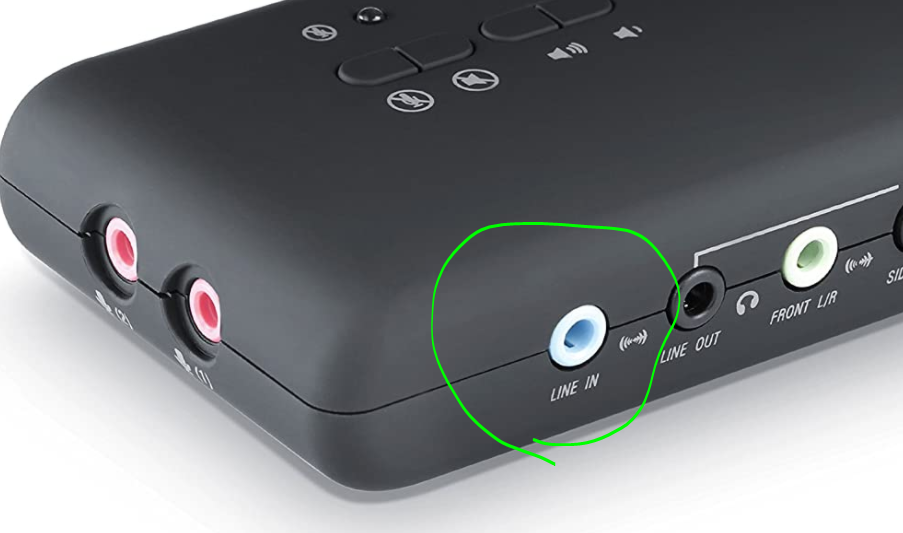

Yes, I have RCA cables going from the NDX CDj's directly into my mixer and USB cables from the NDX's into my laptop.
Yes, I purchased a USB external soundcard which is plugged into my laptop via USB and a headphone jack from the USB into the record input of my mixer. It's definitely plugged into the line-in.
I meant the master volume of my mixer is turned down low not the virtual DJ mixer.

Sure its at the "mini jack" line-in? (probably is, but just to double check)
And if so, check if there is a record volume slider either in the sound card driver settings program.
Or Windows sound control panel.

Yes it's definitely plugged into the Line-In.
I am sorry but I don't know what the record volume slider either in the sound card driver settings program is?
What is the asio or wasapi?

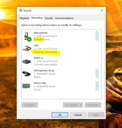

Don't worry about ASIO. It's highly unlikely that your interface uses ASIO. It's a consumer device, not for pro audio or DJs etc.
Go to the recording tab in Windows control panel for audio, highlight the device (likely 'line in') and click properties.
There you should see a 'levels' tab.

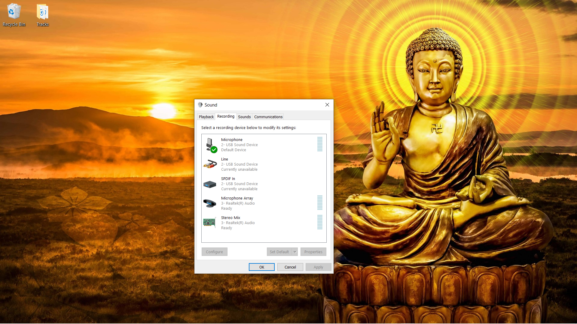

Do you mean here? I turned the levels down to 0 and it's still recording distorted even with 0 levels...

Not sure why it says "unavailable"
can you post a screenshot of VDJ sound settings?
With the record entry drop down open to see what choices VDJ says it has available

It is available, I took that screenshot with it plugged into the laptop that it does not work on because I am factory resetting the other laptop.
Do you have any ideas why it would be recording very loud and distorted?
I will take a screenshot when it's done factory resetting.
