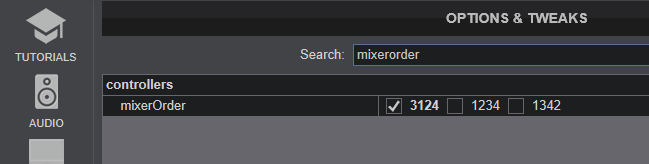

I cannot for the life of me figure out what is wrong with these like faders. I just bought this, used. Hoping it isnt something that needs replaced. Help!!

Could be that it needs replacement, but a little bit odd that both fader ch1 and ch2 acts same way, unless they are equally broken
Its the default mapper right?
Can always try set mix order channel 1234 in the mapper settings, just for sake of testing.
(most all mixers are channel 3124, so maybe there is something)
Should already be 1234 automatic I guess, can also look in the mapper if mixer order looks right there

You could use a MIDI monitor app to check if the "half way" faders are sending the same data as the ones that work correctly.
