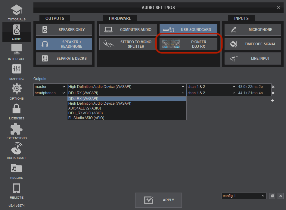

Post an screenshot of your audio config. My first guess is you have both headphone and master configured to the same channels on the sound card.
Post the image and we can advise.

https://snipboard.io/stXf5Z.jpg
https://snipboard.io/PltzUL.jpg

My speaker is through my computer, my headphones are through my board.

Click this button first to set the default audio config for the controller.

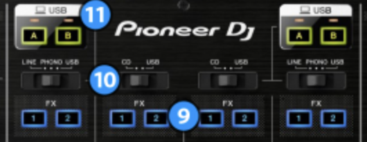

Make sure the switches (10) are all set to USB. My guess is Channel 1 is not as that is the one that is muting.

Wow you are an absolute LIFE SAVER THANK YOU! I was so stressed out that it might have been a hardware problem. Thank you so much. For anyone else who might come across the same issue, on my board (DDJ-RX) this switch was at the front end that would be facing your body rather than on top like the screenshot. I had a feeling it had to do with Phono/Line and I was looking on VDJ but it was on the actual board. Thank you thank you thank you!!!!!
