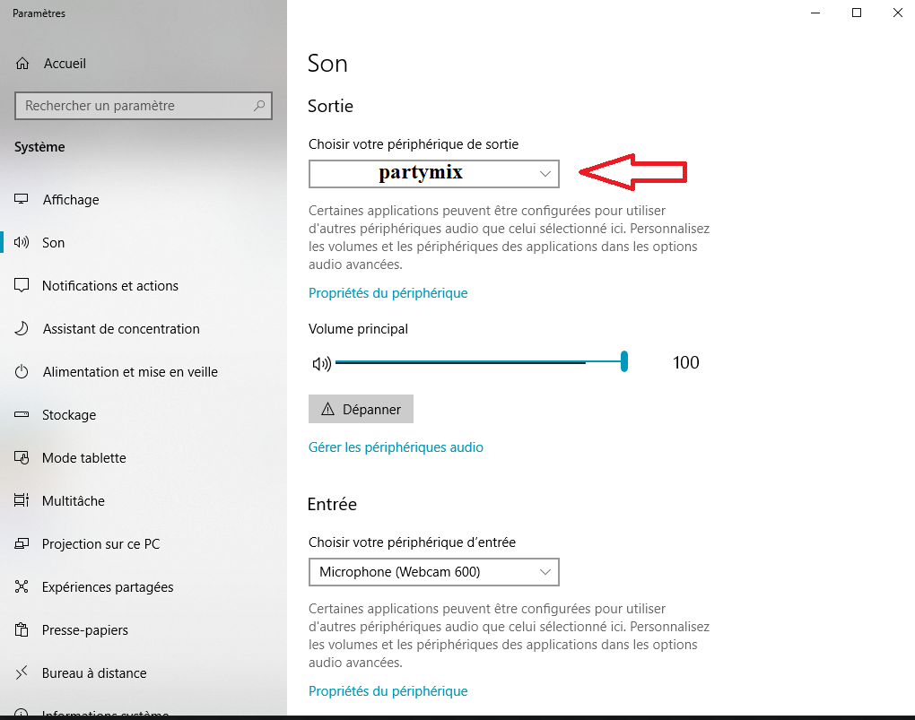

try to put the default partymix sound card in the audio configuration of windows
HOLLY COW!!!
I didn't try by now...but I think you found the reason for the problem.
Working in Home Office I connected my TV as additional Monitor to my Notebook and probably I also set my TV as default output in Windows.
I totally can imagine myself doing something stupid like that and not remembering to set those settings back before starting to Mix.
I'll check and let you guys know.
