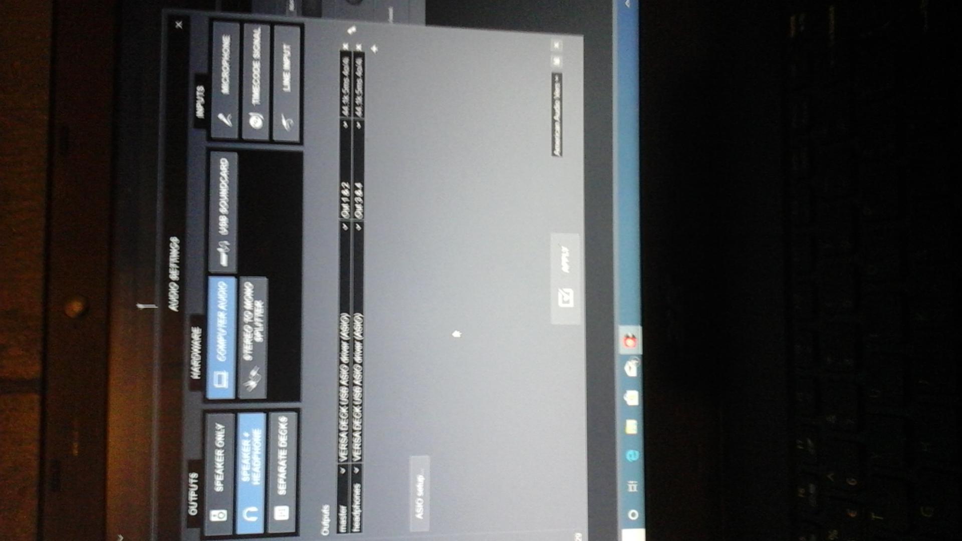

I have. Now I got it working...for some reason it still doesn't see the Versa Deck as a sound card. In the Option for sound I have to first choice is speakers with headphones. The sound card option where the versa deck should be a option? I have to chose computer? Not using TC So nothing there. Again it's weird that I have to chose this option? I will post a pic of the sound option.
Posted Tue 23 Jun 20 @ 9:42 pm

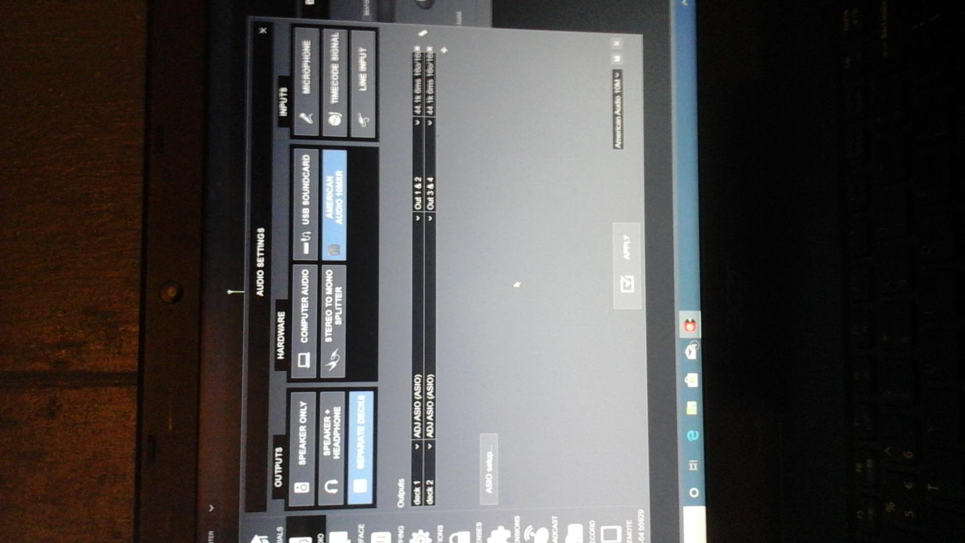

OK as you can see in the 1st pic I got MXR10 connected and it shows up as a sound card option.
The second pic is with the versa deck connected and you will notice it's not a sound card option and I have to use the computer as sound card to get it to work? Again yes I do have the 64 bit drivers installed
Posted Tue 23 Jun 20 @ 9:57 pm
