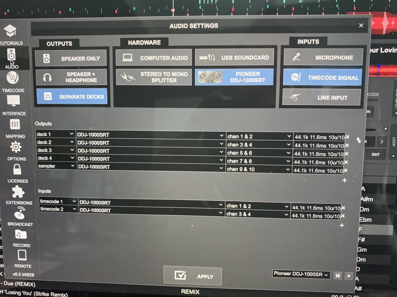

I’ve decided to purchase the PRO license for a month and now trying to get my (serato) DVS working with VDJ. I searched the manual and checked YouTube for help and I think I have it set up right but VDJ aid not detecting any signal.
Any help would be appreciated.

Here’s the screenshot

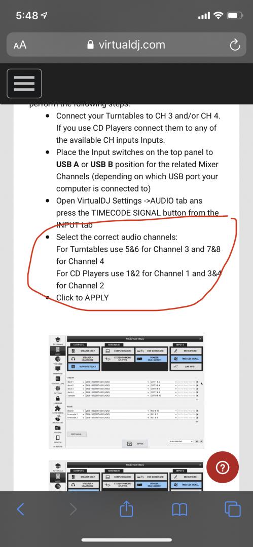

Did you set the channel switches to USB? its not a line-in/phono-in since these inputs are going to the computer.
See here : https://www.virtualdj.com/manuals/hardware/pioneer/ddj1000srt/advancedaudio.html#timecodes

I did but now I see that I have to set the different channels. I didn’t see this part of the manual. I’ll try it. Thanks for your help.
Posted Tue 23 Jun 20 @ 12:50 am
Changed the channels to 5/6 and 7/8 since I’m using turntables and everything works now. Thanks again for your help!
