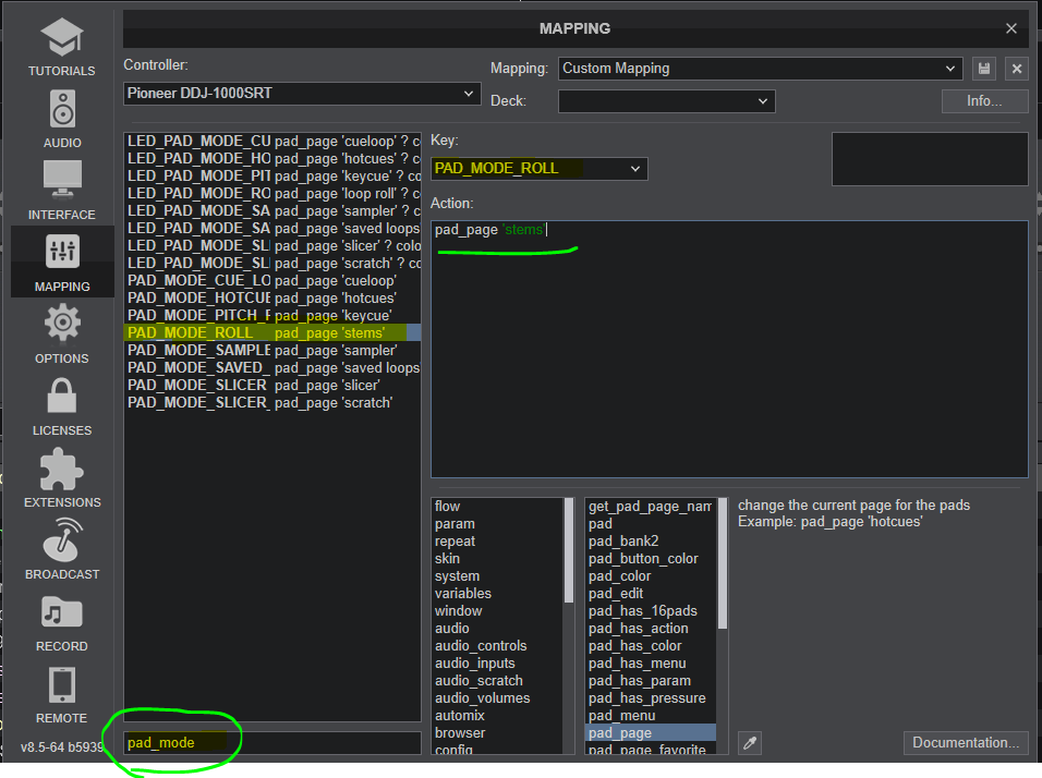

Quite quick and easy to do..
Open the mapper settings, and search pad_mode (see image below)
Then select the one you want to use for it. In image below used the ROLLS to be STEMS instead... as example :)
You can choose other that you prefer
action : pad_page 'stems'
(you want to do same on the LED_PAD_MODE_ROLL, if using the example below, and change from 'loop roll' to 'stems' so that it lights up on selected : pad_page 'stems' ? color 'green' : off)
Posted Mon 22 Jun 20 @ 8:15 pm

Just tried it. It works. I did notice one thing though...
I’m in STEMS mode, and see that all pads for stems are lit
I go to HOT CUE mode, then back to STEMS. At this point, I see that all pads are not lit although I can hear everything.
I’m wondering if it has to do with the action for the LED_PAD_MODE.
Currently I have it as
pad_page ‘’stems’ ? color ’green’:off
Posted Mon 22 Jun 20 @ 11:13 pm
