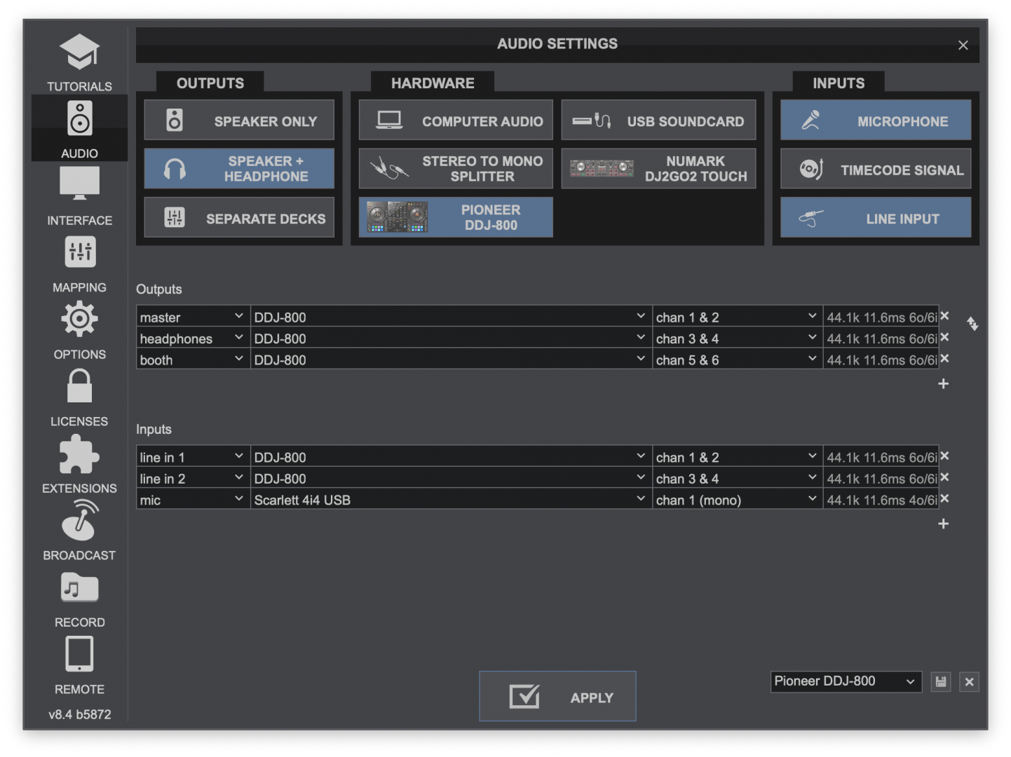

I have mine routed slightly oddly because it suits my setup. So VDJ outputs to the DDJ800 then the DDJ800 into inputs 3&4 on the 4i4.
My mic is routed directly into the 4i4. As I also use this for Zoom/Skype meetings etc.
So VDJ look like this:
Posted Mon 08 Jun 20 @ 5:02 pm

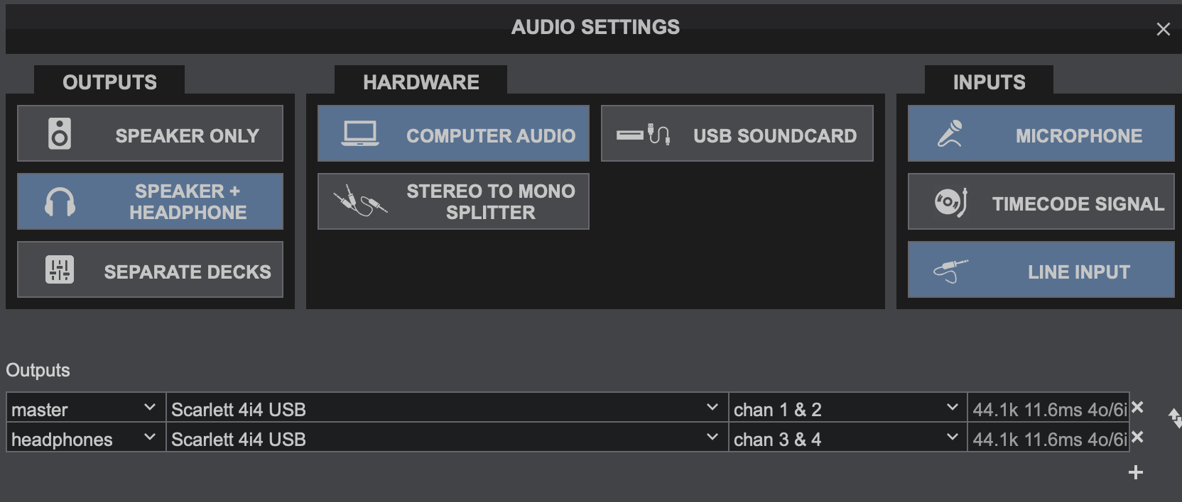

Ok. inside Virtual DJ, set your audio config as such:
Master - Soundcard=Focusrite - Chan 1&2
Headphones - Soundcard=Focusrite - Chan 3&4

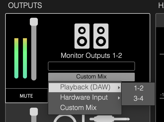

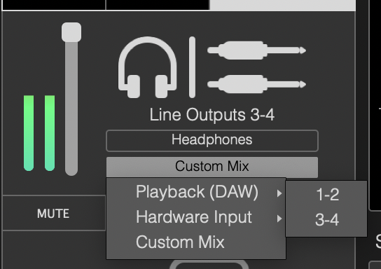

Then in the focus rite software. Click Output routing at the top.
Then set your Monitor Outputs to Playback (Daw) 1&2
Set Line Output 3&4 to Playback (Daw) 3&4
Posted Mon 08 Jun 20 @ 10:51 pm

That doesn't like it does on my Scarlett mix control, but I'll have a look and see if I can sort it.
