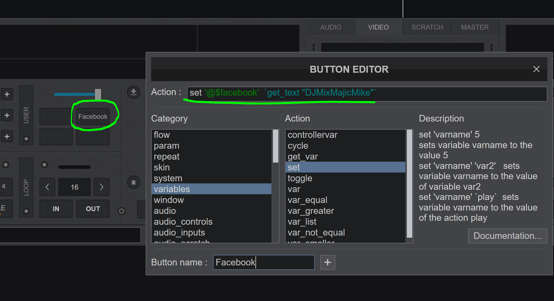

I dot know where to custom the codes text. You explanation do not tell us where to go to make the edits. http://www.virtualdj.com/forums/235213/addons/Broadcaster_GFX_-_Neon.html?page=1
Posted Sun 07 Jun 20 @ 1:42 pm
So set Social media names (and/or messages), use the Custom Buttons in the skin to do so. Use the scripts mentioned further up, and edit for your own name
https://www.virtualdj.com/manuals/virtualdj/interface/decks/decksadvanced/custombuttons.html

How to edit/delet youtube and twitter tag, or write other text without the icon.
Posted Tue 11 Aug 20 @ 2:13 pm
Read the thread. There's a link with HOW TO USE written above it.
Posted Tue 11 Aug 20 @ 3:04 pm

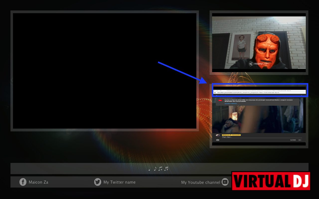

i have Read, and don't realize about messagebox ....thanks
Now my doubt is about screengrab, i want to show in the 3box the chat from facebook..
I test youtube but, the tabs appear toguether..
Posted Tue 11 Aug 20 @ 6:27 pm
You have to resize and position the screengrabber plugin over the chat area :)
Posted Tue 11 Aug 20 @ 7:03 pm
There is only option to "position" that is possible to move or resize but it works like a zoom , its not the same as cut a border of image.
I haven't been able to do it this way yet
Posted Tue 11 Aug 20 @ 9:47 pm
see this video , i have try without sucess
https://youtu.be/ELwcHMsm4dg
Posted Tue 11 Aug 20 @ 10:24 pm
Seems resize the grab area is only implemented on the Windows side currently.
Will hopefully come to the mac plugin soon (mac grabs whole window as of now, if I remember right)

Hi
I can get the screengrab to work but it is always in the screenbox 1. I want it to be in the 3:d sceenbox. How should i do?
Posted Tue 15 Dec 20 @ 2:45 pm
Im to fast :-) Needing 4 deck layout, right?
Posted Tue 15 Dec 20 @ 2:47 pm
The "Extrabox" is a bit of a "work around/hack" to have something extra show.
So to use that, you can for example activate a video FX on deck 4, then switch back to deck 2 after.
To show a screen grab, or something else.
Posted Tue 15 Dec 20 @ 2:52 pm
