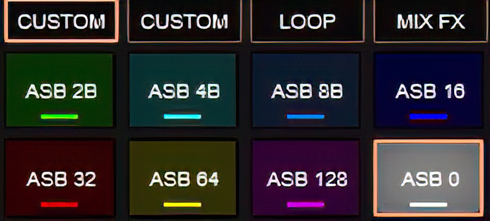

You can add a custom pad page and have them change at any beat interval you like, I have 8 pads which are 2 Beats, 4 beats, 8, 16, 32, 64 and 128 and the final pad turns them off
