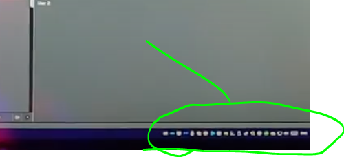

Just bought a Numark Party Mix and bought a Home license for Virtual DJ and I get loads of pops and clicks ... and worst of all tracks just randomly slow down and distort (This only happens when using the Party Mix). I have taken a quick 5 second video to show you .....
https://drive.google.com/file/d/1cUg9i-fNiz9Zlt07kiNQ9v2rqS9fAPpW/view?usp=sharing
Have tried all the problem fixes as part of support and searched the forum but cannot get it fixed. Any ideas?

What is the sound settings you use? sounds like your computer cant keep up.
The quick-fix will be to set higher audio buffer, the distortions are likely due to the audio data at the driver running out of data.
Try set latency to 256 or 512 (even 1024) in VirtualDJ settings.
You can also use these tools to check what may prevent "real time" audio at your computer (such as background apps eating up resources, bad drivers/services etc)
https://www.resplendence.com/latencymon
https://www.thesycon.de/eng/latency_check.shtml
AND...
You might benefit also by "cleaning" up a little ;-) looks like you have a LOT of things running, the task bar bottom right corner is full of stuff.. Might be a good advice to close down some of those :) They might be causing issues with the audio performance. Can also try disable bluetooth etc. Everything running will use a bit of computer resources and potentially even conflict.
(although setting higher latency/buffer will likely fix things, you might want to "optimize" the computer a little for low latency audio performance )

Tried changing the Latency but no joy.
Used Latencymon and its bad. Although it says it could be my CPU throttling .. I know for a fact I have all throttling off in BIOS and Windows Power options. Here is a report:
https://drive.google.com/file/d/15eDMVqJvrw6GSJS_aOTM2eDe-pqa2-tm/view?usp=sharing
Concerning my running programs ... these don't make a difference when I turn these off. Have even tried turning off my Antivirus and Malwarebytes.
Thanks for replying. ;)
