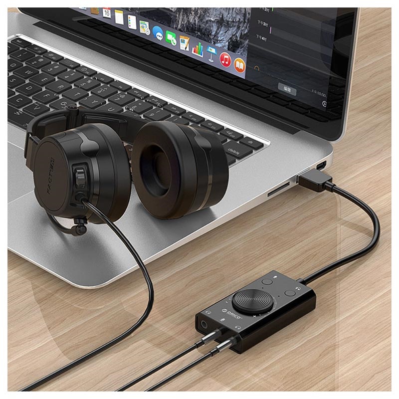

An example of something really simple, that adds 1 more sound channel from your computer :

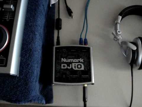

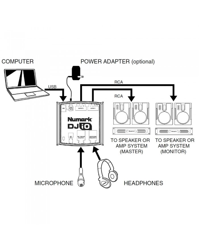

or you can get something that is quite popular among DJs for adding another channel, the Numark DjIO

Think of it as this : - Your computer sends the sound from VirtualDJ to the sound card via usb digitally. Then the sound card routes that sound to analogue RCA signal (per deck), that you can then connect to two different line-in channels at your external analogue mixer.
You will need a sound card that supports TWO stereo (L + R) output - since you want output per deck :)

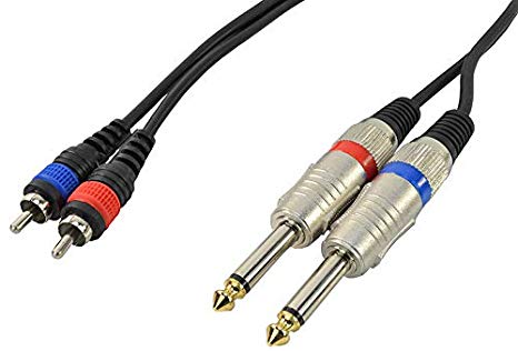

If your mixer has 1/4 jack inputs, you will need an audio cable that fits the sound card in one end, and the mixer in other end.
In this case RCA (L+R) on one end, and 1/4 jack on other end yes :) Those are easy to get at most any "radio / hifi" store

I found lots of sound cards/audio interfaces, but only the Numark DJ IO (first generation) has a USB input. I found a used one fortunately.
