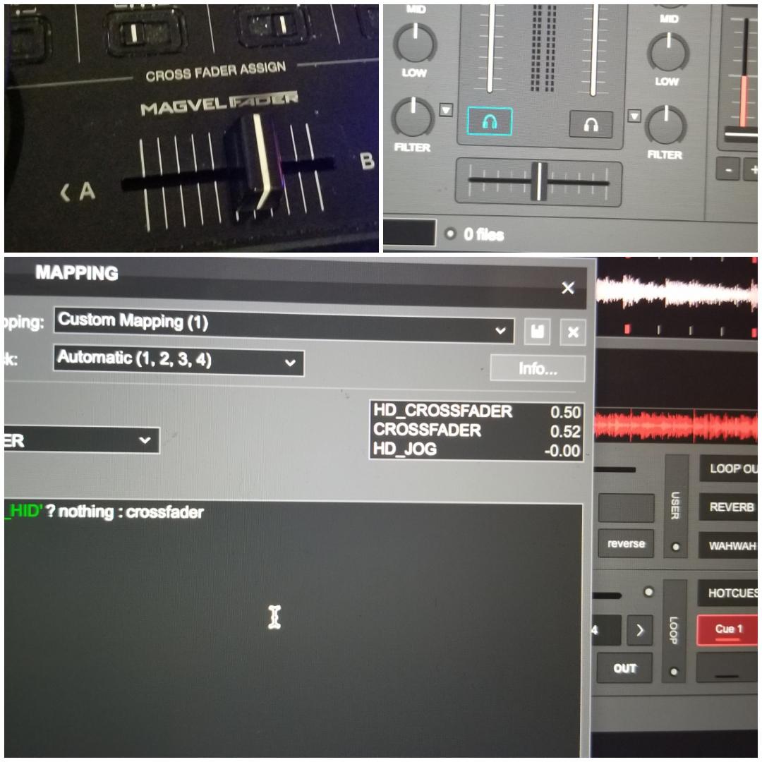

I'm new to both VDJ and to my DDJ-1000 controller, and while setting them up and getting familiar with them, I've discovered that the center position of the crossfader in VDJ is set to something like 80% (almost all the way right) on the controller. No matter what I do to the crossfader settings in VDJ, this is the case. I've downloaded the latest driver and have the latest firmware update, so it's not that. Help?

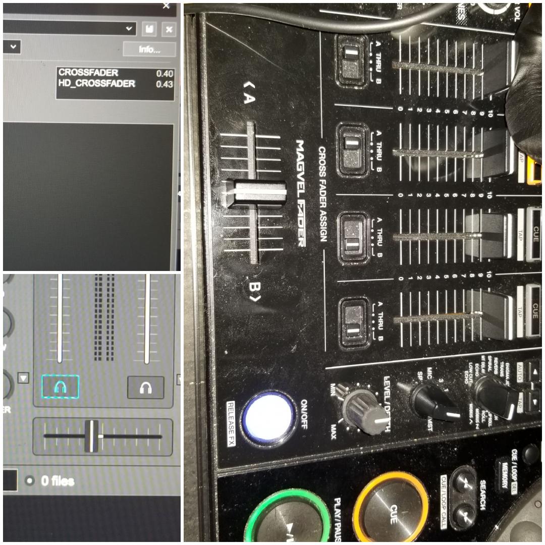

I too am having the same issue with a DDJ-1000. When it it to the left, it reads 0.0. To the right, 1.0. However, dead center on the crossfader isn't 0.5, that occurs slightly to the right. Dead center on the crossfader shows 0.4 in the settings menu. I have reset VDJ and used factory settings and it still appears the same.

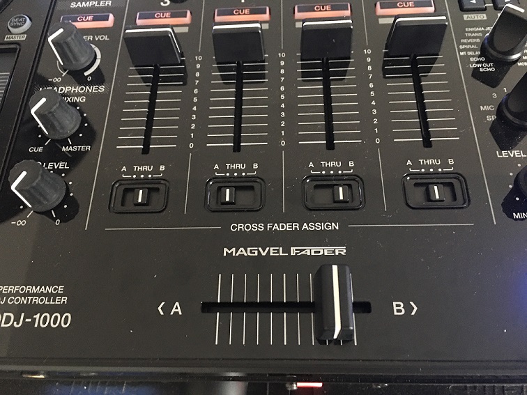

Also seeking a solution for this major bug. just nought brand new ddj1000 yesterday and 80% is the crossfader
