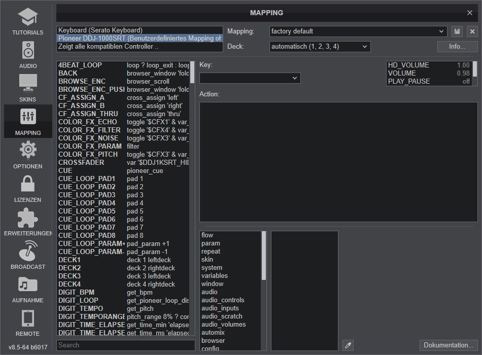

On the mapping page, the dropdown box that says Deck: should have a selection of choices.
There's also a settings option called mixerOrder.
Posted Wed 22 Jul 20 @ 5:09 pm

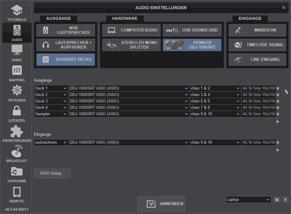

ok, here are my actual settings:
The Channel assignment, faders, deck assignment is correct.
But this is what I actual controll with exaclty those settings shown above in the gain and input section
Posted Wed 22 Jul 20 @ 5:30 pm
Yes, if you've got the Deck: dropdown box set to 1234 you will get 1234 on the mixer.
If you want 3124 you have to change the Deck: setting or the mixerOrder setting.
Posted Wed 22 Jul 20 @ 5:43 pm

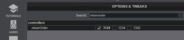

Just open VirtualDJ settings and search for mixerorder
Set it to 3124 (or any other setting you like)
This setting is what dictates the order of the mixer.
DO NOT use deck assignment menu on mappers tab to change "order" as it will brake deck commands
Posted Wed 22 Jul 20 @ 7:25 pm
So what's the point of the Deck: menu and the options there, if you're not supposed to use it?
Posted Wed 22 Jul 20 @ 7:32 pm
You are supposed to use it, but for other tasks.
The deck assignment there has an effect on ALL elements, not just mixer.
So, if you change 1234 to lets say 3412, you are effectively swapping all the decks:
Deck 1 play button becomes deck 3 play button. Deck 2 jog becomes deck 4 jog, e.t.c.
Also the deck assignment menu there is useful in order to swift a controller to use higher number of decks so that you can use 2 or more controllers to control more decks.
So, if you want to change ALL deck components order you use the deck assignment menu
If you want to change ONLY the mixer, you use the mixerOrder setting
Posted Thu 23 Jul 20 @ 6:41 pm
