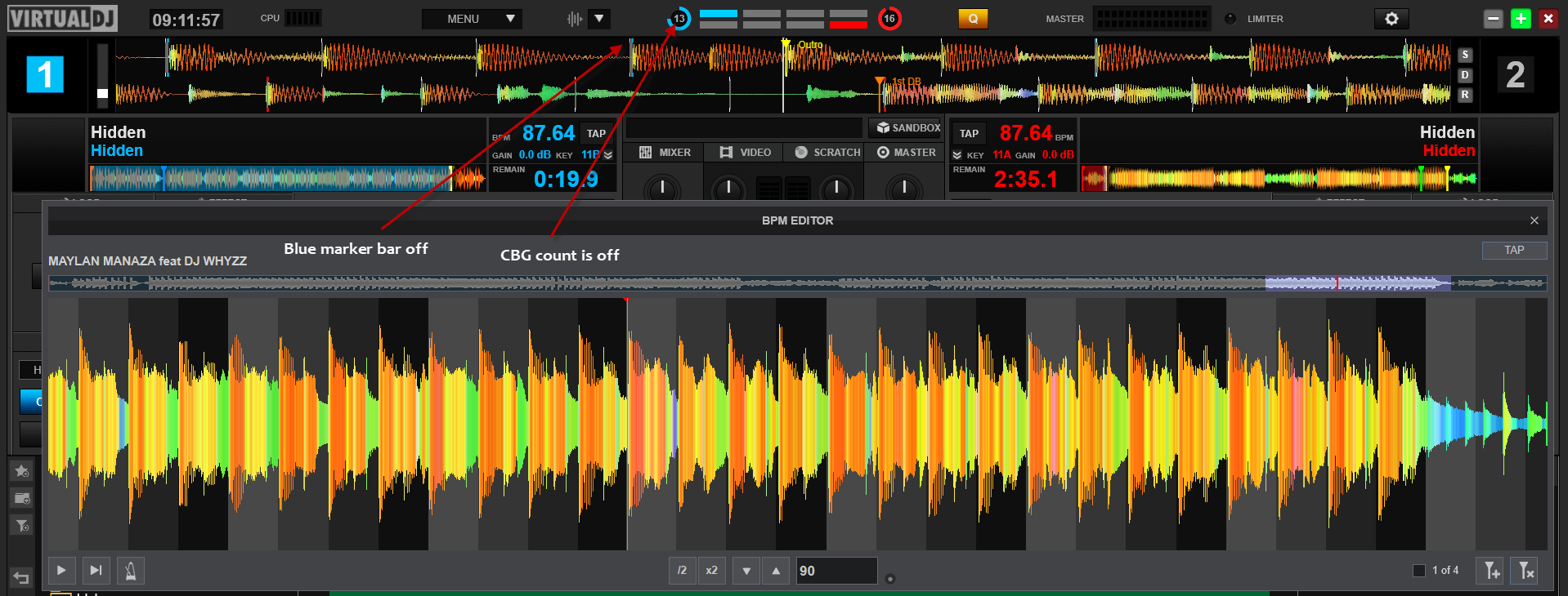

or should I just not worry about it.
Unfortunately, I tend to be a bit of a perfectionist.
I know when the phrase starts where I have Outro marked in yellow in the image.
This is when I want to mix in my next song.
But as you can see - the blue marker bar is off and so is the count.
Can I fix that?
I have gone through a dozen Youtube video's and I don;t seem to be getting it.
Can I fix that?

Press the "tap" button once in the skin, when aligned up where you want to set the first beat of a bar
(or drag the dark shaded background in the bpm editor)
Posted Sun 03 Nov 19 @ 8:33 pm
Got it - thanks!
Posted Sun 03 Nov 19 @ 8:50 pm
