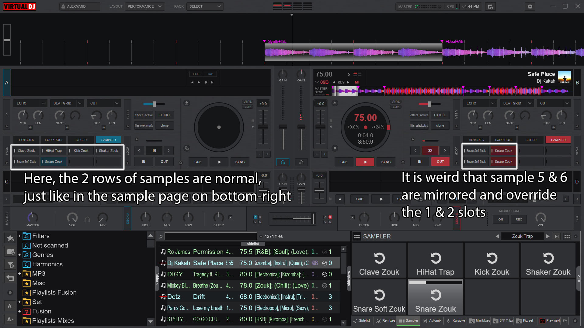

I've had similar problems where the samples were playing on the original BPM, when triggered through the pad, but samples were synced when played from the sample side page itself.
Also, the pad have a weird bug when in sample mode (inconsistently) where samples in slots 5 to 8 are duplicated to slots 1 - 4.
I wiped and reinstalled, and tested both in the new skins and the old default. Here is a screen grab.

This behaviour happens even with all banks, even on a fresh install where I deleted all libraries during the uninstall.
It is not consistent though, or at least I haven't been able to fully reproduce it yet.
Here was the XML of the bank (but the bug would extend to all banks)

It's probably the last 2 samples having column 4 and 5 (starting counting from 0), so probably created/dropped with Sampler being in 5+ Columns as grid, or List view.
So with last lines as
<sample path="Snare Soft Zouk.vdjsample" filesize="170836" group="Snare" col="0" row="1" />
<sample path="Snare Zouk.vdjsample" filesize="264004" group="Snare" col="1" row="1" /> should work.
But even with the above XML, i still get the samples "in-order". So not sure if that was the issue
What hardware/controllers are you using ? Do those have a Pads matrix ?
One other thought. Check /Documents/VirtualDJ/Pads folder and see if you have a "Sampler.xml" file there. If you do, then your custom Sampler Pad page may have a bug in syntax, so delete it or rename it and restart VirtualDJ to use the default/implemented one.

I was using a Reloop Mixtour.
At this point, I fully reinstalled VDJ 2020, and can't reproduce the same situation.
To be noted, with a fully fresh install, I had the same problem happen once with a default sample page (Famous).
After that, and for the last 2 hours, I haven't had the problem with duplicate samples on the pad, and no sync issues to report.

Okay, behaviour is back, and it is linked to my Reloop Mixtour.
The moment I turn it on, the sample duplication bug appears.
When I turn it off, samples revert to normal on the pad.
FIY, the bug still appears with factory mapping on the Mixtour
Posted Sat 02 Nov 19 @ 1:01 pm
i think the issue is the mixtour only allows 4 samples per deck from the controller.
Posted Sat 02 Nov 19 @ 3:06 pm
This bug started 2 updates ago or so, it was all fine before.
Plus the bug only appears on one of the decks' pad as shown on screengrabs.
Posted Sat 02 Nov 19 @ 5:30 pm
