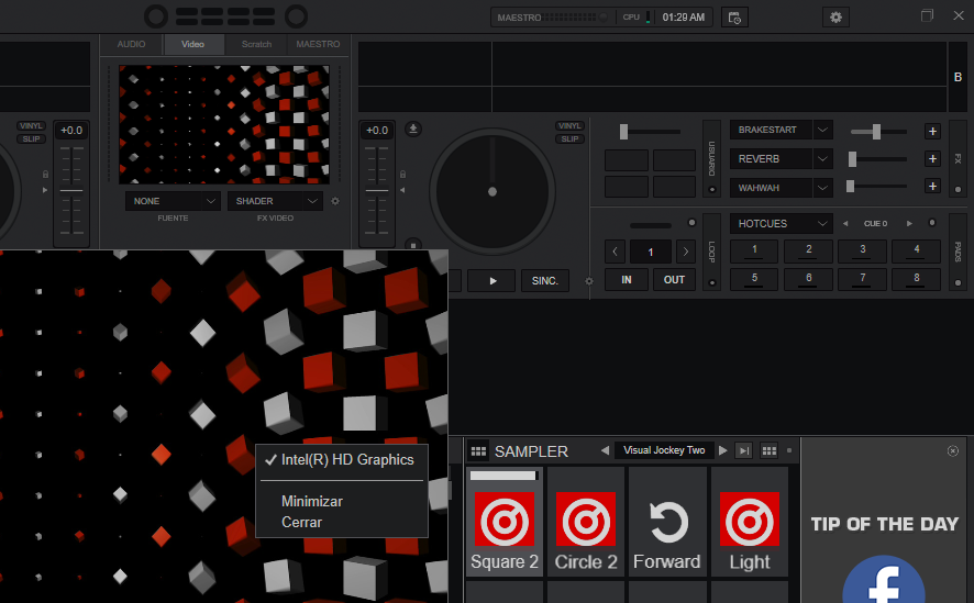

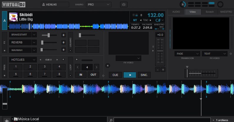

I Installed the 64-bit version to try and find me that the videos will not be seen, only the audio will be skipped over the trays where it would tend to see the video solo falling in black. If you can not get an error in the configuration, simply my pc is not compatible. In 32-bit version works normal.
Mi setup:
Intel Core I5 M450
8GB DDR3 RAM
Integrated Graphics
Note that some samples downloaded from the vdj web site are correctly seen by all:

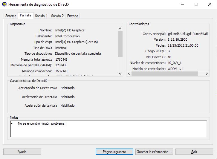

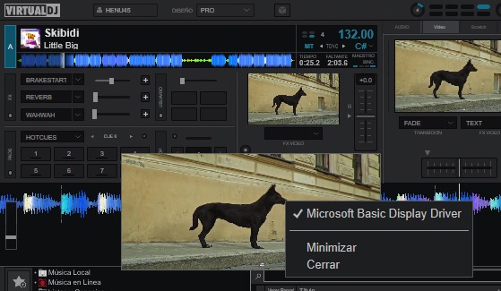

It has also been proven by uninstalling the driver and running VDJ x64 with the basic windows 10 drivers and it works fine. When I install the official drivers, VDJ stops working again.

For some reason if duplicated my post, you had problems of internet between my images and published without my consent. The complete details are present in this post, the problem of having the video drivers without installing and that the PC does not recognize HDMI, also high resolutions.
I tried tried with videoUseDXVA=NO and videoUseDXVA=YES. No results
I'm trying to figure out which video formats work since MP4 doesn't work

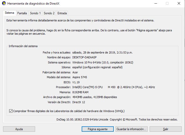

What are your specifications on the PC?

Thanks but I still having the issue I update the drivers on video cards and everything and nothing happens no video output, I am using HD Graphics Card Intel generation the DirectX 12 not find any problems. I have two computers with the same issue. I need help ASAP thanks

VirtualDJ 2020 de 64 bits está diseñado para Windows 10 y en equipos del 2012 para acá. Tiene manejo de instrucciones optimizado para procesadores recientes. Cualquier procesador anterior puede seguir usando la versión de 32 bits (para eso se dejó para compatibilidad con equipos que no vayan con la nueva versión de 64 bits) y el Core i5 M450 es de 2010, tiene limitaciones ahora para la versión de 64 bits de VirtualDJ 2020.
Si no funciona la versión de 64 bits con Windows 10 y DXVA=NO en su equipo, tendrá que usar la de 32 bits hasta que actualice el equipo por uno más reciente. Los desarrolladores del software consideraron esta actualización para ser usada en equipos que no tengan más de 7 años (de hecho al principio era para equipos del 2015 para a ca y aumentaron el rango pero ya no podían ir mas atrás sin perder las optimizaciones que buscaban). De cualquier modo he pasado su solicitud para su consideración.
