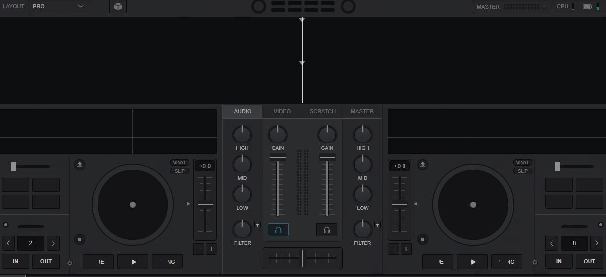

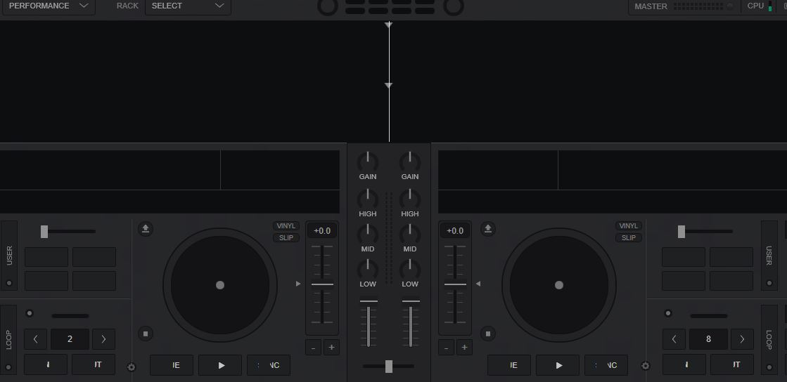

I'm seeing rending issues with the the Pro and Performance skins but only on the 64-bit version only?
See below where the loop and cue buttons would be
Also getting it in the option screen too
If i use the 32-bit version it works fine with no render issues.

What happens if you resize VDJ (take it out of fullscreen and drag it smaller/bigger)? Do the glitches go away?
I'm not getting it here, so I suspect it's your graphics card/driver. What do you have experimentalSkinEngine set to? Try changing it...
Posted Mon 23 Sep 19 @ 12:53 pm
Seems to render the buttons fine if it comes out of full screen mode, although i would never use it in the mode.
SkinEngine set to auto, but doesnt seem to make any difference whether its set to no, yes or auto.
Posted Mon 23 Sep 19 @ 12:59 pm

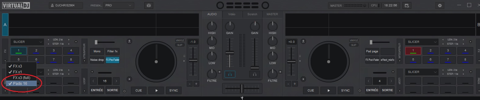

Small bug observed: when I restart the software, FX3 slots disappear and 16 mode pads are displayed instead. I tried to deselect Pads16, but each time I restart it is selected again. This only happens when the controller is connected ( Mixtrack Platinum, default mapping, 32 and 64 bits). Pro skin used. Not very important, VDJ 2020 is so beautiful!!!!
Is this only with the Platinum connected ? Or are you also connecting another controller with 16 Pads layout ?
I see in your account stats that you have used a Traktor F1. If so, it explains the automation.
Posted Thu 26 Sep 19 @ 5:04 pm
Thank you for your quick answer. Yes, I also have a F1 Traktor. This happens if I connect the Platinum or F1 or both. But not if I don't connect a controller.
Thank you for your help
Posted Thu 26 Sep 19 @ 5:13 pm
